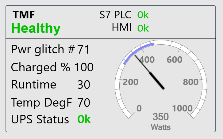

69a5ab5745f16
This is how I am using the SNMP data in VTScada. The green status comes from our network switch in each plantroom and the middle UPS data comes from our Vertiv UPS's with an SNMP card.
I used ireasonging to get the OID's for all this information.
You cant use ireasoning to scan an entire network, that is not a use case for SNMP.
If you are looking to scan your network to find all devices with open SNMP ports (port 161), then use NMAP on Linux and something like Angry IP Scanner (go into its settings and tell it to also probe for port 161) on Windows.
Once you find all those devices, then use the Ireasoning software to do a general 'walk' of the device to see what sort of device it is and what the generic OID return.
Then you may need to get a specific MIB for that device if you want / need granular device specific data (Like I did for the network switches).
