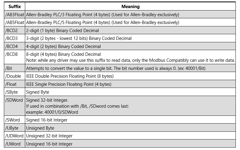

686776e597951
I found the multi-write widget and used it to attempt what i described above. Which is resulting in 4 separate write single register (06) commands and not giving me my expected results. Upon reading the GE description again it seems i need to write multiple registers (16) in the same message. Is there no suffix for an unsigned 64-bit integer in VTScada or any way to write 4 contiguous 16 bit registers in the same 16 command?
![686776e597951](serve/attachment&path=686776e597951) I found the multi-write widget and used it to attempt what i described above. Which is resulting in 4 separate write single register (06) commands and not giving me my expected results. Upon reading the GE description again it seems i need to write multiple registers (16) in the same message. Is there no suffix for an unsigned 64-bit integer in VTScada or any way to write 4 contiguous 16 bit registers in the same 16 command?
