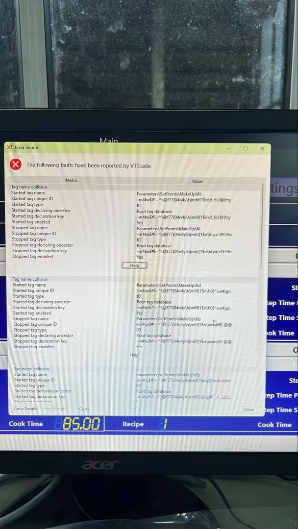

I am facing error of 'Tag Name Collision' in my project?
https://www.vtscada.com/help/Content/Dialogs/10522%20Tag%20Name%20Collision.htm?Highlight=tag%20name%20collision
686dccfad7695
May I know how to resolve it step by step?
I am facing error of 'Tag Name Collision' in my project? https://www.vtscada.com/help/Content/Dialogs/10522%20Tag%20Name%20Collision.htm?Highlight=tag%20name%20collision ![686dccfad7695](serve/attachment&path=686dccfad7695) May I know how to resolve it step by step?
export your tag database to Excel and look for tag names with matching tag ID's. Ensure that each tag ID is unique and re-sync the tag database with your excel file.
