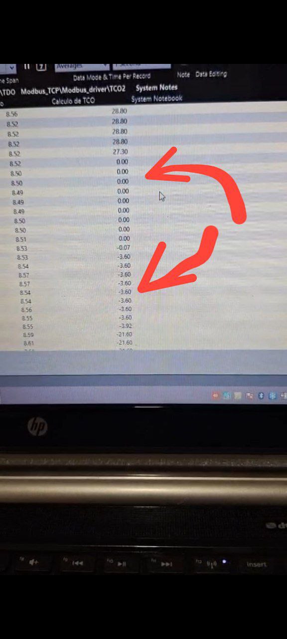

I have a device that receives information from a sensor. The sensor information is displayed on a graph. At certain points on this device, the variable becomes negative and resets to zero. How can I exclude this negative and reset variable from the graphs so that it doesn't apply to the invoice, since it makes no difference and will end up interfering with Excel exports? (Customer request)68978d54ced45
I have a device that receives information from a sensor. The sensor information is displayed on a graph. At certain points on this device, the variable becomes negative and resets to zero. How can I exclude this negative and reset variable from the graphs so that it doesn't apply to the invoice, since it makes no difference and will end up interfering with Excel exports? (Customer request)![68978d54ced45](serve/attachment&path=68978d54ced45)

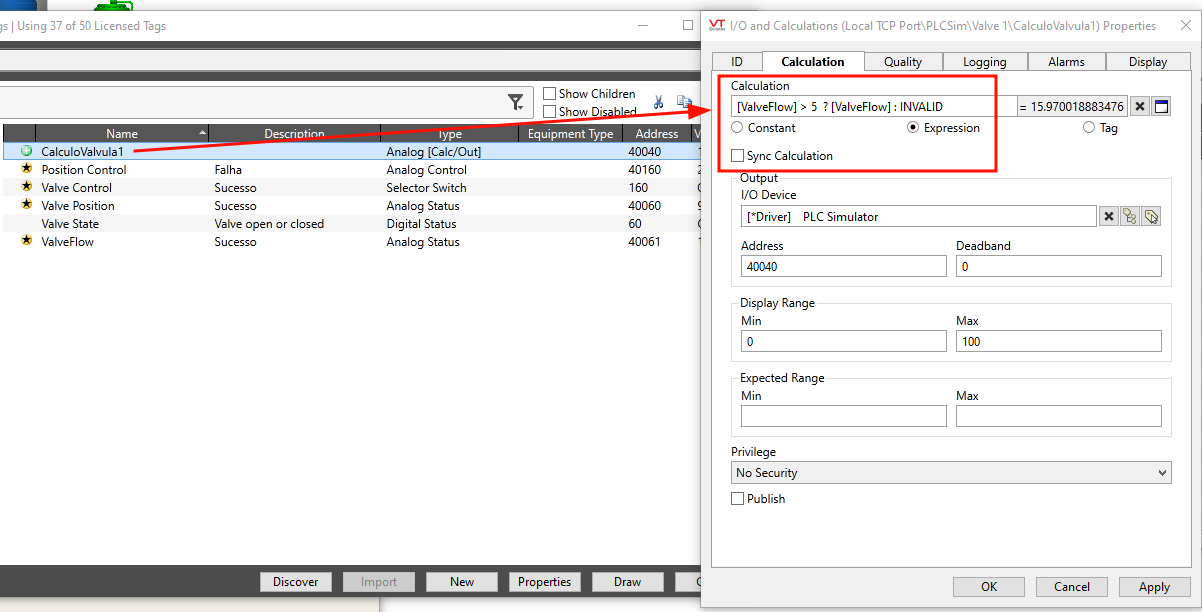

The best way to handle this might be to create a calculation tag which references the measured I/O and stores the modified data using a calculation.
For example, a simple ternary should handle this
[MyTag] > 1 ? [MyTag] : INVALID
note I haven't tested that code but in theory that would work.
The best way to handle this might be to create a calculation tag which references the measured I/O and stores the modified data using a calculation. For example, a simple ternary should handle this ```` [MyTag] > 1 ? [MyTag] : INVALID ```` note I haven't tested that code but in theory that would work.

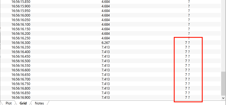

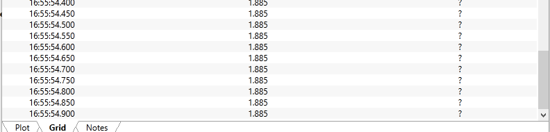

I think it worked...if it's less than 5, it appears as invalid...and if it's greater than 5, the value appears...however, how do I remove the "?" when the value appears? So it doesn't end up as "16?"
68ae11fa0eda4
68ae11fa25a76
I think it worked...if it's less than 5, it appears as invalid...and if it's greater than 5, the value appears...however, how do I remove the "?" when the value appears? So it doesn't end up as "16?" ![68ae11fa0eda4](serve/attachment&path=68ae11fa0eda4) ![68ae11fa25a76](serve/attachment&path=68ae11fa25a76)

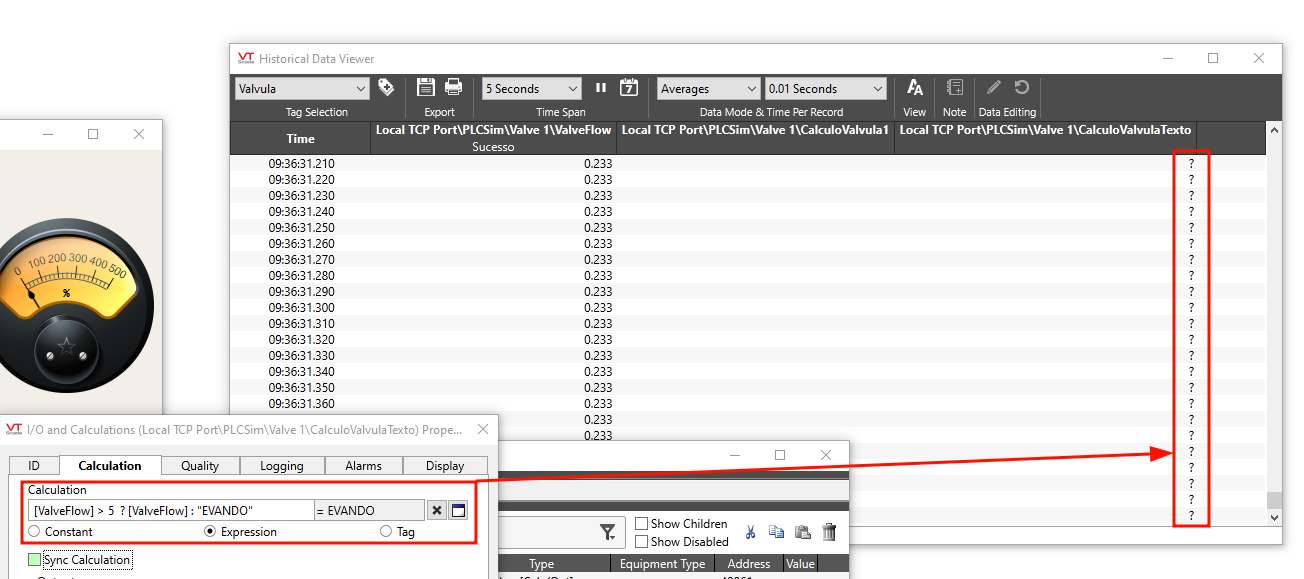

I ran a test here. It's working in the calculation, the word appears when it's below 5, but it doesn't appear in the GRID plot. Does anyone know how to fix it?
68aefc44d4925
I ran a test here. It's working in the calculation, the word appears when it's below 5, but it doesn't appear in the GRID plot. Does anyone know how to fix it? ![68aefc44d4925](serve/attachment&path=68aefc44d4925)
