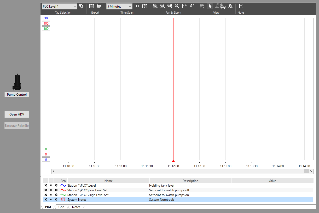

How do I configure the "reports" button to automatically generate a report through HDV, without having to go to the Reports page? I'm having trouble.
Como faço para configurar o botão "relatórios" para gerar automaticamente um relatório pelo HDV, sem precisar acessar a página de Relatórios? Estou com dificuldades.
Como faço para configurar este botão (com as tags que precisam ser exportadas) para que eu possa simplesmente clicar nele?
6968f66d9569c
How do I configure the "reports" button to automatically generate a report through HDV, without having to go to the Reports page? I'm having trouble. How do I configure this button (with the tags that need to be exported) so that I can simply click the button? ![6968f66d9569c](serve/attachment&path=6968f66d9569c)
Create a report tag and configure it for the report you want (saved tag, list, etc...) then add a trigger condition to the report tag. It will run each time the trigger is activated.
Create a report tag and configure it for the report you want (saved tag list etc...) then add a trigger condition to the report tag. It will run each time the trigger is activated.
