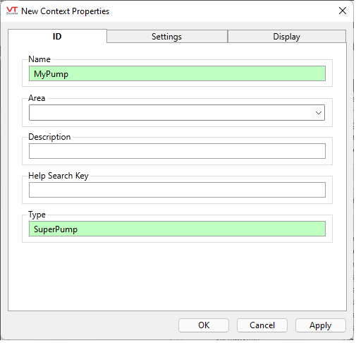

To Define a new Tag Type, please ensure that you have a context tag with, at a minimum, the following fields filled in the ID Tab:
Once you apply this, you can go back to the tag browser, right click on the context tag and then select to create the new tag type.
If you still have issues, please check to see that your logged-in user (assuming your app requires credentials) has permission to create tag types.
![61a8dcc8218d5](serve/attachment&path=61a8dcc8218d5)
