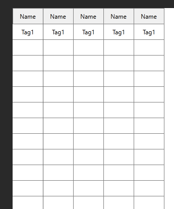

Does anyone have a working example of a basic page using a gridlist function?
The example in the help documentation does not work when copy and pasted into my code, and I have been the extra things to get it working but in the end the Gridlist is not pulling the example list of Data[#][#] or Title[#] information past the first inputs.
Is there something I am missing?

Sure, I have been adjusting things to see what I can get to work but it's still doing the same thing.
{======== SSH Communication Summary ============}
{ This page is an overview of the sites with comm }
{ alarms triggerd but seperated into their channels }
Title = "rzr_Channel_Alarms";
WinFlag = 0;
Color = "<FF292929>";
PageHeight = 900;
PageWidth = 900;
GridFont;
Header;
Data;
DataForm;
Constant #Name             = 0;
Constant #Area            = 1;
Constant #Description    = 2;
Constant #IODev            = 3;
Constant #Address        = 4;
PageX;
PageY;
PageMinWidth;
PageMinHeight;
PageVWidth;
PageVHeight;
PageMaintainAspectRatio = 1;
NoStretch = 1;
Main
            GridFont  = Scope(\VTSDB, "MeterFont")\Value;
            Header[#Name]         = "This Name";
            Header[#Area]         = "Some Area";
            Header[#Description] = "A little Description";
            Header[#IODev]         = "I/O Controller Dev";
            Header[#Address]     = "Address 12345";
            Data[0][0] = "Tag1";
            Data[1][0] = "Tag2";
            Data[2][0] = "Tag3";
            Data[0][1] = "Area1";
            Data[1][1] = "Area1";
            Data[2][2] = "I'm a tag";
            Data[1][3] = "PollDrvr1";
            Data[0][4] = "40001";
            DataForm = "%s";
GUITransform(184, 781, 805, 217   { Reference rectangle         },
           1                    { Scale Left                  },
           1                    { Scale Bottom                },
           1                    { Scale Right                 },
           1                    { Scale Top                   },
           1                    { No overall scaling          },
           0, 0, 1, 0           { No movement; visible; res   },
           0, 0, 0                 { Not selectable              },
         \System\GridList(Header     { Column Header Array             },
                          Data       { Data Array                      },
                          Dataform     { Format for Text                 },
                          122        { Column widths array           },
                          3         { # Data rows                   },
                          5         { # Data cols                   },
                          15, 94      { Grid BGnd, Grid color         },
                          2, 1         { Grid line width, line style    },
                          20, 50     { Row/Title height              },
                          0, 0         { Horiz/Vert cell padding         },
                          0, 0         { Horiz/Vert Scroll position     },
                          1, 1         { Disable V/H scroll bars         },
                          1            { Disable column sizing           },
                          1            { Disable Sorting                 },
                          1            { Disable selected cell           },
                          0, 0         { Enable V/H grid lines          },
                          1            { LockFirstColumn                 },
                          Invalid      { Sort                            },
                          0          { SelectedRow                     },
                          0            { SelectedColumn                  },
                          GridFont    { GridFontParm                    },
                          0            { GetSortKeyScope                },
                          1            { EnabelBorderParm                },
                          140        { CellTextColorParm                },
                          71        { TitleTextColorParm            },
                          166        { TitleBackColorParm            },
                          174        { TitleGridColorParm            },
                          0            { LockFirstColColorParm            },
                          0            { CaseSortParm                    },
                          0            { DisableControlsParm            },
                          0            { IsFocuableParm                }
Sure, I have been adjusting things to see what I can get to work but it&#039;s still doing the same thing. {======== SSH Communication Summary ============} { This page is an overview of the sites with comm } { alarms triggerd but seperated into their channels } {===================================================} [ Title = &quot;rzr_Channel_Alarms&quot;; WinFlag = 0; Color = &quot;&lt;FF292929&gt;&quot;; PageHeight = 900; PageWidth = 900; GridFont; Header; Data; DataForm; Constant #Name = 0; Constant #Area = 1; Constant #Description = 2; Constant #IODev = 3; Constant #Address = 4; PageX; PageY; PageMinWidth; PageMinHeight; PageVWidth; PageVHeight; PageMaintainAspectRatio = 1; NoStretch = 1; ] Main [ GridFont = Scope(\VTSDB, &quot;MeterFont&quot;)\Value; Header[#Name] = &quot;This Name&quot;; Header[#Area] = &quot;Some Area&quot;; Header[#Description] = &quot;A little Description&quot;; Header[#IODev] = &quot;I/O Controller Dev&quot;; Header[#Address] = &quot;Address 12345&quot;; Data[0][0] = &quot;Tag1&quot;; Data[1][0] = &quot;Tag2&quot;; Data[2][0] = &quot;Tag3&quot;; Data[0][1] = &quot;Area1&quot;; Data[1][1] = &quot;Area1&quot;; Data[2][2] = &quot;I&#039;m a tag&quot;; Data[1][3] = &quot;PollDrvr1&quot;; Data[0][4] = &quot;40001&quot;; DataForm = &quot;%s&quot;; GUITransform(184, 781, 805, 217 { Reference rectangle }, 1 { Scale Left }, 1 { Scale Bottom }, 1 { Scale Right }, 1 { Scale Top }, 1 { No overall scaling }, 0, 0, 1, 0 { No movement; visible; res }, 0, 0, 0 { Not selectable }, \System\GridList(Header { Column Header Array }, Data { Data Array }, Dataform { Format for Text }, 122 { Column widths array }, 3 { # Data rows }, 5 { # Data cols }, 15, 94 { Grid BGnd, Grid color }, 2, 1 { Grid line width, line style }, 20, 50 { Row/Title height }, 0, 0 { Horiz/Vert cell padding }, 0, 0 { Horiz/Vert Scroll position }, 1, 1 { Disable V/H scroll bars }, 1 { Disable column sizing }, 1 { Disable Sorting }, 1 { Disable selected cell }, 0, 0 { Enable V/H grid lines }, 1 { LockFirstColumn }, Invalid { Sort }, 0 { SelectedRow }, 0 { SelectedColumn }, GridFont { GridFontParm }, 0 { GetSortKeyScope }, 1 { EnabelBorderParm }, 140 { CellTextColorParm }, 71 { TitleTextColorParm }, 166 { TitleBackColorParm }, 174 { TitleGridColorParm }, 0 { LockFirstColColorParm }, 0 { CaseSortParm }, 0 { DisableControlsParm }, 0 { IsFocuableParm } ) ); ]

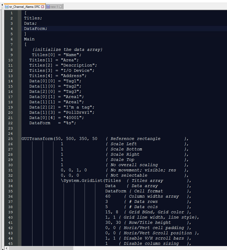

Give this a try.
Title = "rzr_Channel_Alarms2";
WinFlag = 0;
PageHeight = 900;
PageWidth = 900;
GridFont;
Header;
Data;
DataForm;
Constant #Name             = 0;
Constant #Area            = 1;
PageX;
PageY;
PageMinWidth;
PageMinHeight;
PageVWidth;
PageVHeight;
NoStretch = 1;
Init [
  If 1 Main;
            Header = New(5);
            Data   = New(20,5);
            DataForm = "%s";
Main [
           1                    { Scale Left                  },
           1                    { Scale Bottom                },
           1                    { Scale Right                 },
           1                    { Scale Top                   },
                          3         { # Data rows                   },
                          5         { # Data cols                   },
                          Invalid      { Sort                            },
                          0          { SelectedRow                     },
                          0            { CaseSortParm                    },
Give this a try. ```` {======== SSH Communication Summary ============} { This page is an overview of the sites with comm } { alarms triggerd but seperated into their channels } {===================================================} [ Title = &quot;rzr_Channel_Alarms2&quot;; WinFlag = 0; Color = &quot;&lt;FF292929&gt;&quot;; PageHeight = 900; PageWidth = 900; GridFont; Header; Data; DataForm; Constant #Name = 0; Constant #Area = 1; Constant #Description = 2; Constant #IODev = 3; Constant #Address = 4; PageX; PageY; PageMinWidth; PageMinHeight; PageVWidth; PageVHeight; PageMaintainAspectRatio = 1; NoStretch = 1; ] Init [ If 1 Main; [ Header = New(5); Data = New(20,5); GridFont = Scope(\VTSDB, &quot;MeterFont&quot;)\Value; Header[#Name] = &quot;This Name&quot;; Header[#Area] = &quot;Some Area&quot;; Header[#Description] = &quot;A little Description&quot;; Header[#IODev] = &quot;I/O Controller Dev&quot;; Header[#Address] = &quot;Address 12345&quot;; Data[0][0] = &quot;Tag1&quot;; Data[1][0] = &quot;Tag2&quot;; Data[2][0] = &quot;Tag3&quot;; Data[0][1] = &quot;Area1&quot;; Data[1][1] = &quot;Area1&quot;; Data[2][2] = &quot;I&#039;m a tag&quot;; Data[1][3] = &quot;PollDrvr1&quot;; Data[0][4] = &quot;40001&quot;; DataForm = &quot;%s&quot;; ] ] Main [ GUITransform(184, 781, 805, 217 { Reference rectangle }, 1 { Scale Left }, 1 { Scale Bottom }, 1 { Scale Right }, 1 { Scale Top }, 1 { No overall scaling }, 0, 0, 1, 0 { No movement; visible; res }, 0, 0, 0 { Not selectable }, \System\GridList(Header { Column Header Array }, Data { Data Array }, Dataform { Format for Text }, 122 { Column widths array }, 3 { # Data rows }, 5 { # Data cols }, 15, 94 { Grid BGnd, Grid color }, 2, 1 { Grid line width, line style }, 20, 50 { Row/Title height }, 0, 0 { Horiz/Vert cell padding }, 0, 0 { Horiz/Vert Scroll position }, 1, 1 { Disable V/H scroll bars }, 1 { Disable column sizing }, 1 { Disable Sorting }, 1 { Disable selected cell }, 0, 0 { Enable V/H grid lines }, 1 { LockFirstColumn }, Invalid { Sort }, 0 { SelectedRow }, 0 { SelectedColumn }, GridFont { GridFontParm }, 0 { GetSortKeyScope }, 1 { EnabelBorderParm }, 140 { CellTextColorParm }, 71 { TitleTextColorParm }, 166 { TitleBackColorParm }, 174 { TitleGridColorParm }, 0 { LockFirstColColorParm }, 0 { CaseSortParm }, 0 { DisableControlsParm }, 0 { IsFocuableParm } ) ); ] ````
Hello crd,
The code you sent is working. I would not have known from the Gridlist example it was needed to separate the array points into their own module. Thanks for the help, it's very appreciated!
