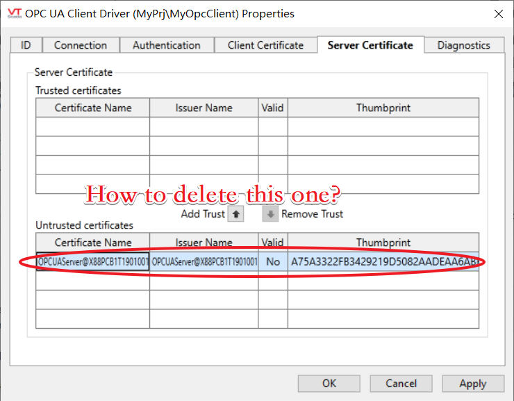

how to delete a untrusted certificate from OPC UA Client Driver properties?
how to delete a untrusted certificate from OPC UA Client Driver properties? Thanks.
6359d62706bd1
how to delete a untrusted certificate from OPC UA Client Driver properties? Thanks. ![6359d62706bd1](serve/attachment&path=6359d62706bd1)

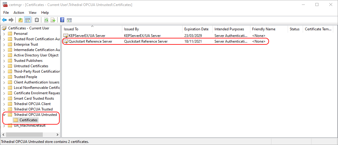

You'll need to use the MMC Certificate Manager for that.
Run certmgr.msc, open the tree to find Trihedral OPCUA Untrusted | Certificates, select the certificate you're not fond of and click the delete key.
Hopefully this image helps:
635ac0d4ec81f
You'll need to use the MMC Certificate Manager for that. Run `certmgr.msc`, open the tree to find `Trihedral OPCUA Untrusted | Certificates`, select the certificate you're not fond of and click the delete key. Hopefully this image helps: ![635ac0d4ec81f](serve/attachment&path=635ac0d4ec81f)
