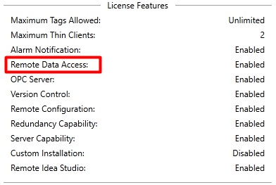

What are the Remote Data access ? Which licenses need to be purchased? Remote access licenses will be enabled

What is the Remote configuration & Remote Idea Studio? Which functions are specifically included
Thank you and look forward to your reply

This is included with Development and can be purchased in a Runtime by selecting third-party data. It is for items such as the REST API.
