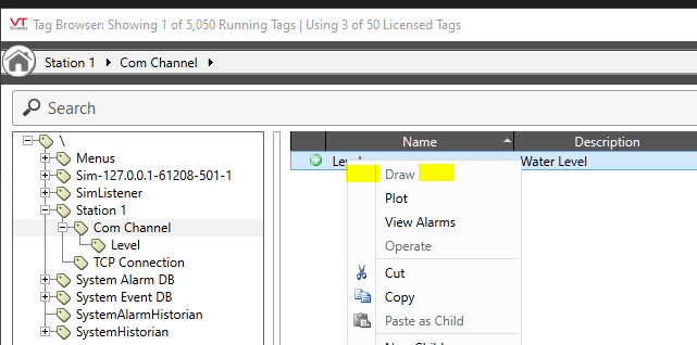

I was following the quickstart video and I can not go further because “draw” is grayed out. Is that not available in the Light version?
How to proceed to visualize this parameter?

VTScadaLIGHT does include the tools to do this. Typically, if you are unable to see the draw button, it is because the tag you have clicked is of a type which does not have any widgets or because your user does not have the privilege to use the idea studio.
Can you let us know the tag type you are looking to draw and confirm that you have access to the idea studio?

I just ran through the simulator using a fresh VM with a new installation of VTScadaLIGHT and did not have any issue following along with Andrew's Quick Start tutorial. I suspect you have inadvertently done something in your application or missed one of Andrew's steps. I would suggest starting the tutorial with a new application and confirming that you do have VTScadaLIGHT with access to the IdeaStudio (Andrew does show how the launch the Idea Studio directly in this tutorial).
Let me know how you make out.
