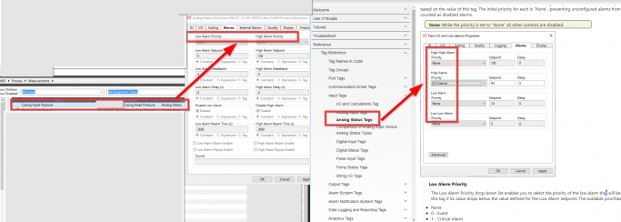

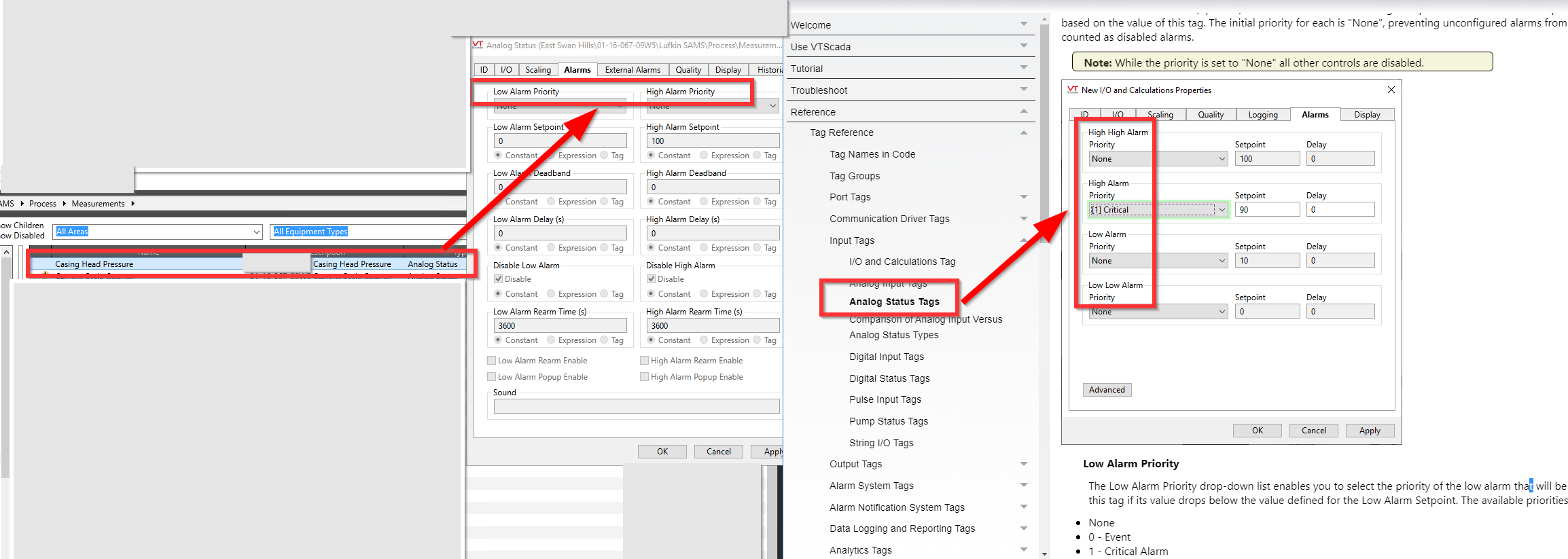

I built a Lufkin SAMS controller inside of my VTScada and it automatically built all the TAG's as either Analog Status or Digital Status TAG's (Legacy TAG's) I am trying to set the lowlow / low / high / highhigh limits for the Analog Status points but I found that these types only allow for a Low/High alarm, but in the support document the picture used for this TAG is the Calculations I/O Analog Alarm TAB that has the 4 options instead. Picture attached.
  • Is there a way to get the 4 limit options for the Analog Status TAG?
  • Is there a reason that the device tag built the tags as legacy tags?
  • How could I get the 4 limit options in the current TAG's that I have? 63f53a2ec823a
I built a Lufkin SAMS controller inside of my VTScada and it automatically built all the TAG's as either Analog Status or Digital Status TAG's (Legacy TAG's) I am trying to set the lowlow / low / high / highhigh limits for the Analog Status points but I found that these types only allow for a Low/High alarm, but in the support document the picture used for this TAG is the Calculations I/O Analog Alarm TAB that has the 4 options instead. Picture attached. - Is there a way to get the 4 limit options for the Analog Status TAG? - Is there a reason that the device tag built the tags as legacy tags? - How could I get the 4 limit options in the current TAG's that I have? ![63f53a2ec823a](serve/attachment&path=63f53a2ec823a)
The simple way to add the extra alarms is to just add alarm tags as children to these tags. You can then make as many associated alarms as you like.
