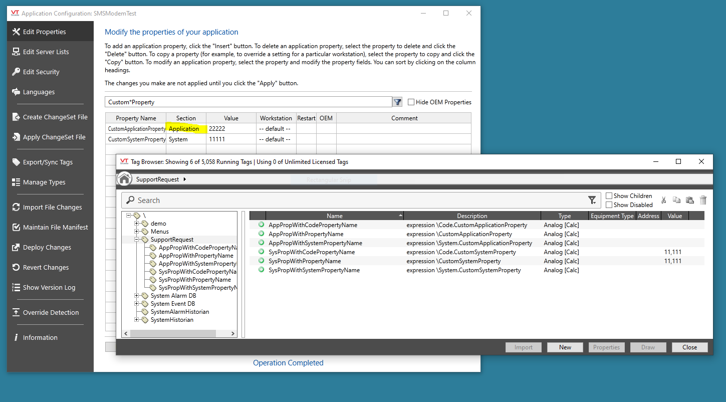

Actually \System.PropertyName returns invalid. See below.
Also (see below) none of the expressions suggested in the help or in these replies ...
\Code.PropertyName
\PropertyName
... work with *"Application" properties.
*I've highlighted the word "Application" to provide context.
6467800446010
> I believe \Property name is the same as \System.PropertyName Actually \System.PropertyName returns invalid. See below. Also (see below) none of the expressions suggested in the help or in these replies ... ```` \Code.PropertyName \PropertyName \System.PropertyName ```` ... work with *"Application" properties. *I've highlighted the word "Application" to provide context. ![6467800446010](serve/attachment&path=6467800446010)
