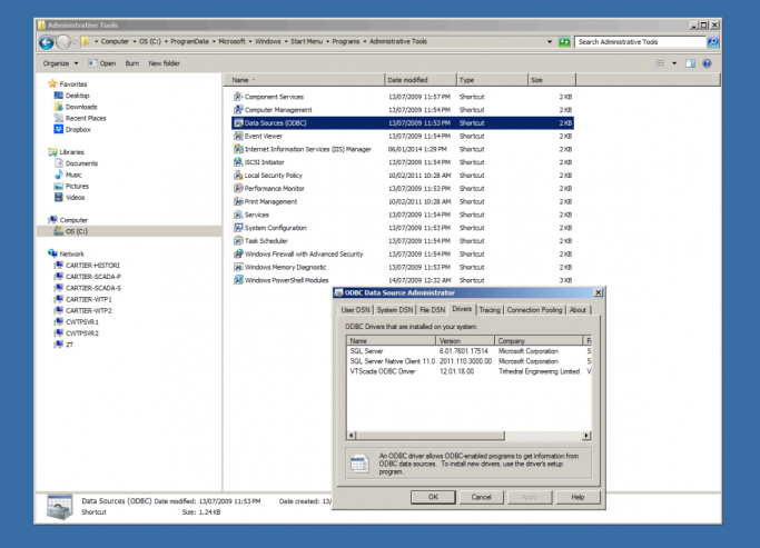

Yeah, it's here.
64a6ba5cdaffc
That doesn't answer my question though. Are there command line options for VTScadaODBCDriverInstall.exe?
Yeah, it's here. ![64a6ba5cdaffc](serve/attachment&path=64a6ba5cdaffc) That doesn't answer my question though. Are there command line options for VTScadaODBCDriverInstall.exe?
