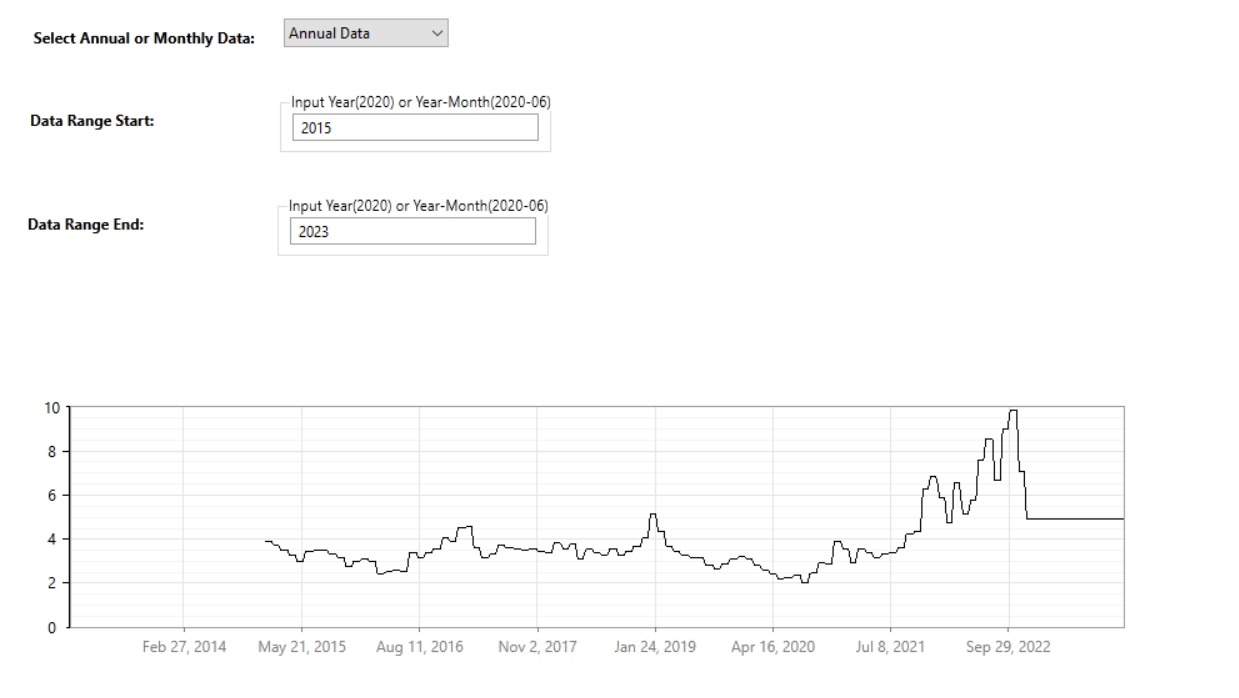

Goal is to change the api link according to user preference(monthly or annual), fetch the data and plot it :
657fe56f1ada9
(the script runs on trigger tag every 7 seconds)
When I tried it, the function only works at application startup ( i.e. response struct object returns correct data)
But after changing api URL from monthly to annual, the whole script runs again as usual, on trigger. But a new api call should bring new data; that’s not happening; specifically the httpsend’s pResponse struct is not populating with new data even though the URL argument changes

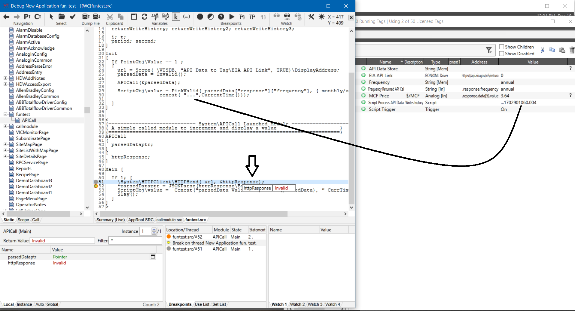

When running the HTTPSend function in a launched module, the debugger shows this:
657fe79ce1324
Look like the whole script runs, the module runs seperately as a 'launched module'
Httpresponse is always invalid and thus Valid(parsedData) also shows false(0) in tag browser Script tag's value

Hey @mahin101,
It looks like you have created a nice tool to import data. While I don't have the quick solution to your issue, I do have a link to a video which will hopefully make the debugging process a bit easier for you:
Video on Advanced Diagnostics: https://www.youtube.com/watch?v=WizPfwUrGlQ
