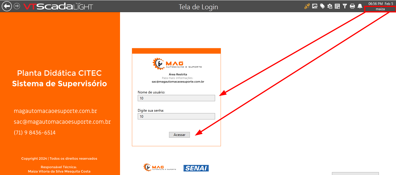

How do I add VTScada's native account fields to my supervisor?
How do I add VTScada's native account fields to my supervisor? I need to create a login screen, as it will be for teachers and students, and each user has their respective permissions.
65c14dc93b0e3
65c14e1ec2ee6
How do I add VTScada's native account fields to my supervisor? I need to create a login screen, as it will be for teachers and students, and each user has their respective permissions. ![65c14dc93b0e3](serve/attachment&path=65c14dc93b0e3) ![65c14e1ec2ee6](serve/attachment&path=65c14e1ec2ee6)

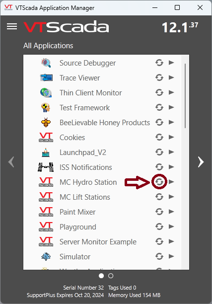

After you put your custom code in, you need to click the import button in the VAM to bring the code into the application.
This allows you to update multiple files and prep code changes in a running application.
65ca26fedf301
After you put your custom code in, you need to click the import button in the VAM to bring the code into the application. This allows you to update multiple files and prep code changes in a running application. ![65ca26fedf301](serve/attachment&amp;path=65ca26fedf301)
