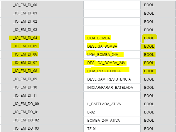

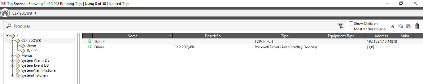

I would like to know how the address of the Micro820's digital inputs and outputs is created, being used by the CCW for the VTSCada using the Rockwell driver? I tried to do it using IO_EM_DI_06 as an example, but it didn't work.

I would like to know how the address of the Micro820's digital inputs and outputs is created, being used by the CCW for the VTSCada using the Rockwell driver? I tried to do it using IO_EM_DI_06 as an example, but it didn't work. ![66183f8f77160](serve/attachment&path=66183f8f77160) ![661841390ca28](serve/attachment&path=661841390ca28)

I don't see a value under your port tag, make sure you have your workstation in the server list.

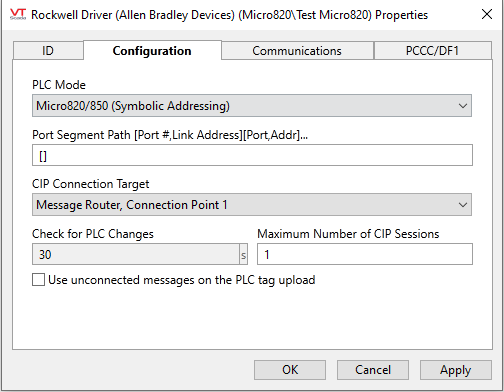

Also you need to change your port segment path to "[]". Make sure Micro820/850(Symbolic Addressing) is checked under the Rockwell Tag.

You may have figured out your issue already but just a couple things to check. I don't see a value under your port tag, make sure you have your workstation in the server list. Also you need to change your port segment path to "[]". Make sure Micro820/850(Symbolic Addressing) is checked under the Rockwell Tag. ![662a786802a1e](serve/attachment&path=662a786802a1e)
