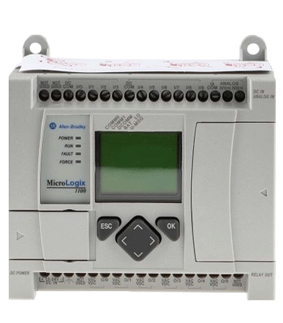

I'm trying to communicate between the Allen-Bradley MicroLogix 1100 and VTScada.
I did the following procedures:
  1. I created a Context TAG with the name of my PLC;
  2. Then, within the Context TAG, I created another TCP/IP tag;
  3. In the TCP/IP TAG I entered the Address of my PLC and the Port: 44818;
  4. Within the TCP/IP TAG, I created the Driver TAG and selected the Rockwell Allen Bradley Devices Driver;
  5. In the Configuration tab, I selected the following items: 5.1 PLC Mode: Compactic Logix/ ControlLogix (Logical Addressing) 5.2 Port Segment: [1,2] 5.3 CIP Connection Target: Message Router, Connection Point 1 5.4 Check for PLC Changes: 30 5.5 Maximum Number of CIP Sessions: 1
I left the other tabs as standard, I didn't change them.
Then, having selected the Driver, I click to import but the driver does not appear.
Can someone help me?!

I think you should be using the PLC Mode "PCCC over CIP", however I've not tried the MicroLogix yet - worth reading the help file below and assosated pages:
https://www.vtscada.com/help/Content/D_Tags/D_RockwellDriverTag.htm?tocpath=Reference%7CTag%20Reference%7CCommunication%20Driver%20Tags%7CRockwell%20Driver%20Tag%7C_____0
Let us know how you get on.

I don't have plans (or a spare MicroLogixs) to test this, however the help files do a good job at explaining the Octal addressing, link below. The addresses will be unique to your application so cannot help with them. Though if you are seeing any error messages on the driver they will help you out too.
https://www.vtscada.com/help/Content/D_Tags/Allen-Bradley-Addressing.htm
