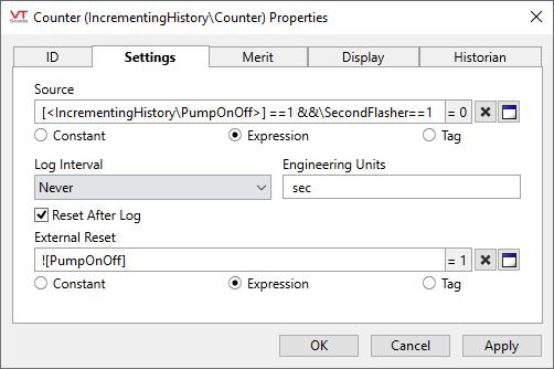

The counter tag logs at reset, so if you select never to log, and put in an expression to reset it when the pump goes off, it will only log at that point. Have a look at the counter tag help files - they explain it better.
https://www.vtscada.com/help/Content/D_Tags/Dev_CounterTags.htm?Highlight=counter
Something like the below:
Assumes the pump is on when tag "PumpOnOff" is on.
6703f7494da24
The counter tag logs at reset, so if you select never to log, and put in an expression to reset it when the pump goes off, it will only log at that point. Have a look at the counter tag help files - they explain it better. https://www.vtscada.com/help/Content/D_Tags/Dev_CounterTags.htm?Highlight=counter Something like the below: Assumes the pump is on when tag "PumpOnOff" is on. ![6703f7494da24](serve/attachment&path=6703f7494da24)
Thank you, works great. I also have a calculation tag and a Analog IO tag and would like to log these one time when pump goes off. Can these also be setup to log one time?
