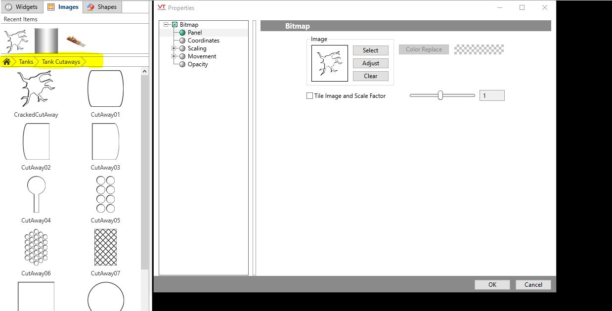

Hi folks, can someone educate me on the tank cutaways... there are loads of cutaways in the standard library, is there a way to combine these with a tank image to make a transparent cutaway for use with an analog bar, or are we limited to the tanks that have a transparent bar?
Note, I've created my own .png images and imported these, however it would be nice to use the standard library cutouts.
It's a great question... I'm not sure how one would use those cutout graphics.
For such things as tank cutaways, images can have two colours present that are treated as transparent, see the help documentation for the Two Color Bar Widget.
For such things as tank cutaways, images can have two colours present that are treated as transparent, see the help documentation for the [Two Color Bar Widget](https://www.vtscada.com/help/Content/D_Widgets/Dev_TwoColorBarWidget.htm).
Hi Graham, This does not work with the cutouts in the Image library below, or have I missed something?
6788f8df91cc4
Hi Graham, This does not work with the cutouts in the Image library below, or have I missed something? ![6788f8df91cc4](serve/attachment&path=6788f8df91cc4)
Got it - I was using a standard Top Bar Widget not the Two Colour Widget... Works now.
