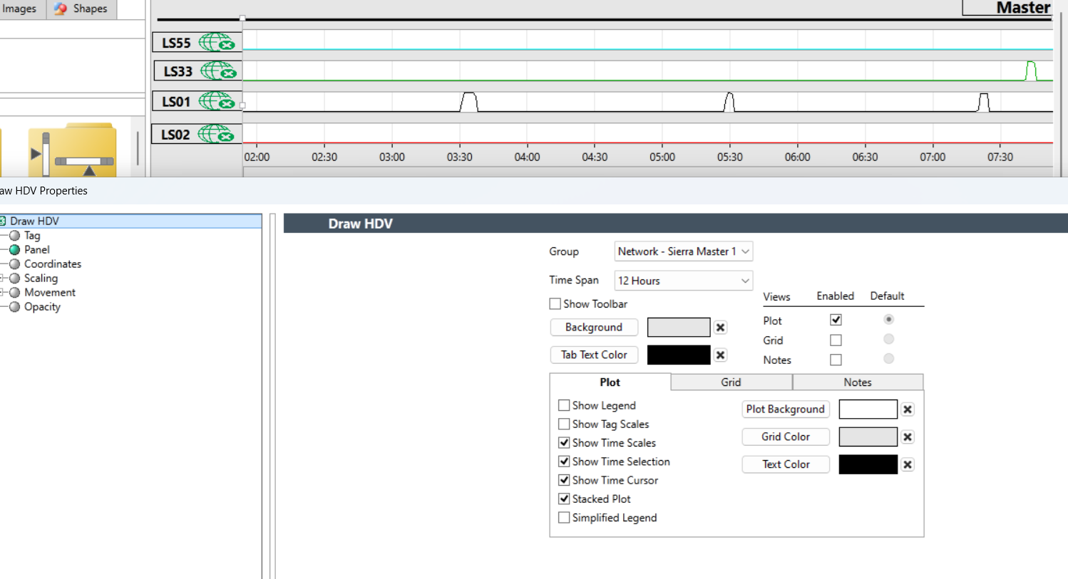

I am having trouble trying to see the full properties of a Draw HDV object. Currently has 4 trends displayed, trying to just add a 5th. See the screen shots. I tried locating the Group name but can't find it anywhere. Tried searching in tag browser too. Any insight on where to find the location to break this graphic down for editing would be very helpful and appreciated.

I am having trouble trying to see the full properties of a Draw HDV object. Currently has 4 trends displayed, trying to just add a 5th. See the screen shots. I tried locating the Group name but can't find it anywhere. Tried searching in tag browser too. Any insight on where to find the location to break this graphic down for editing would be very helpful and appreciated. Thanks! Ben ![6769b22903389](serve/attachment&path=6769b22903389)
You can use the standard HDV to save a named trend group and then reference that named group in your HDV Object.
