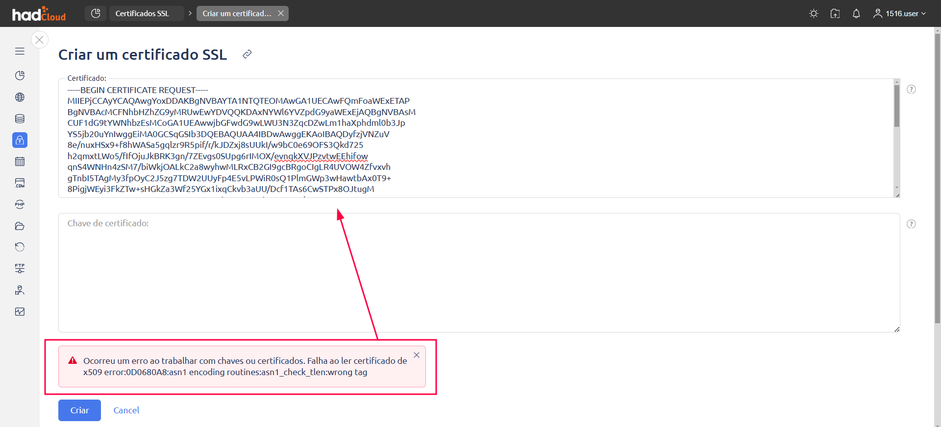

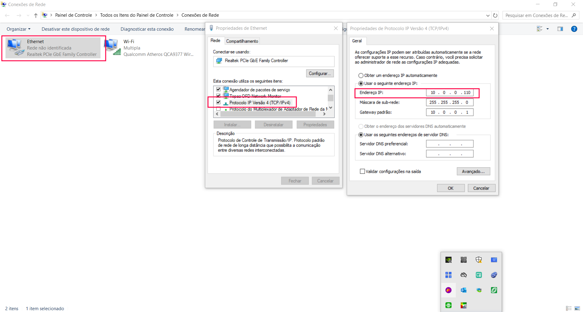

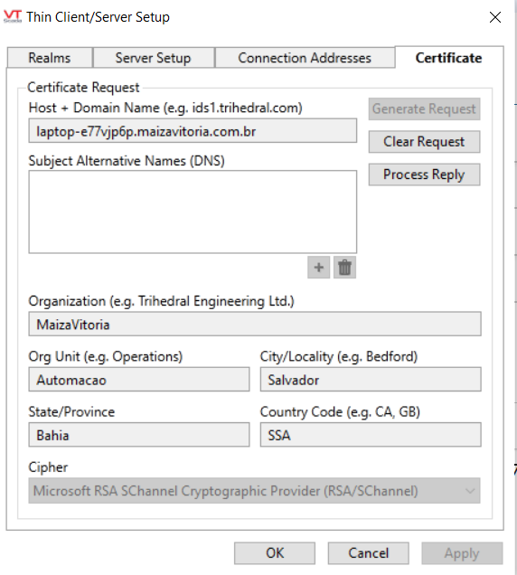

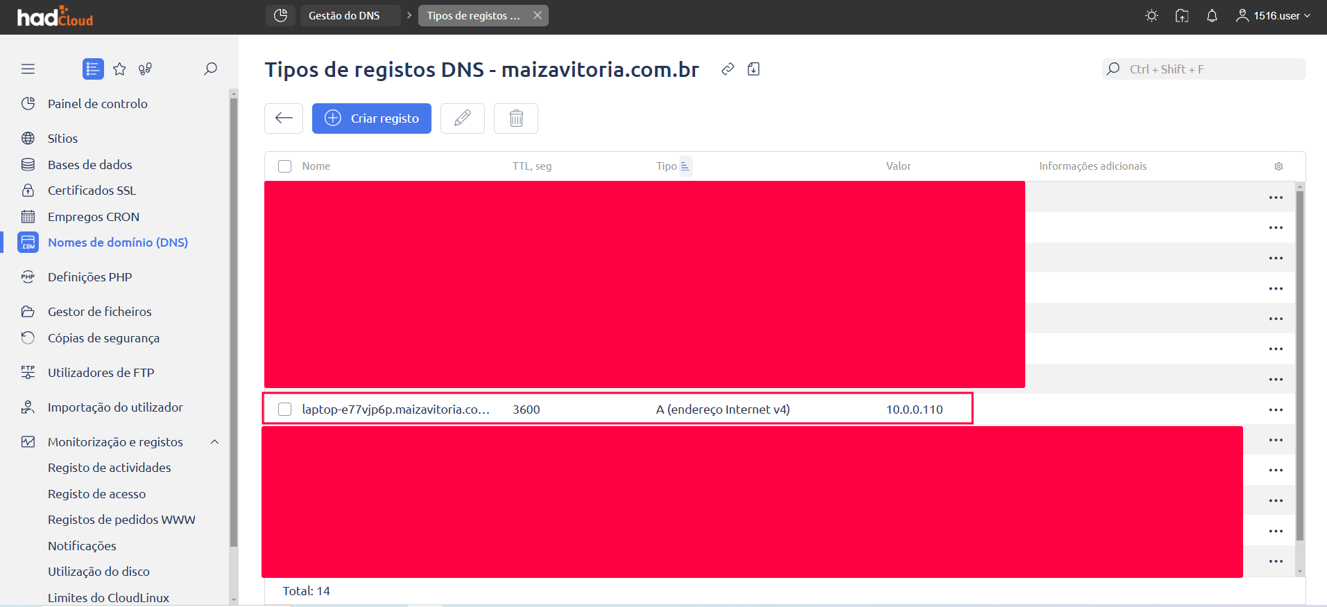

I'm trying to access my application through remote access. I tried to do the procedure in the SSL video (https://www.youtube.com/watch?v=1DSan2ltzFg
) but without success. I'm using a domain (maizavitoria.com.br) and hosting. I'm getting an error with the SSL certificate in the manager. Where am I going wrong? Please help me. The Switch used is this one: PLANET FSD-503 (https://planet.com.br/produtos/fsd-503)
The application is already running at the factory and I need to make it work because this is the only thing missing.

If I understand correctly, you are using VTScadaLIGHT, the free version of VTScada for applications up to 50 I/O. By design, this free version requires a VPN in order to connect via the one free Thin Client connection from outside your network. This is to prevent misuse of the free license. This may be the issue.
