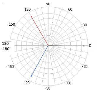

Pretty new to VTScada. (Only a couple weeks in) The main difficulty I am having (though I'll probably find others) is getting a rotation on the end of a line rather than in the center. The diagram would look like this:
682231fdd8990
I have a tag for each phase that is its angle, but I don't know how to configure it to rotate on the end of a line.
Note: The lines of the chart aren't necessary but would be nice. :-)
Pretty new to VTScada. (Only a couple weeks in) The main difficulty I am having (though I'll probably find others) is getting a rotation on the end of a line rather than in the center. The diagram would look like this: ![682231fdd8990](serve/attachment&path=682231fdd8990) I have a tag for each phase that is its angle, but I don't know how to configure it to rotate on the end of a line. Note: The lines of the chart aren't necessary but would be nice. :-)

I think the easiest solution to make the rotation about the middile of the line is to make the line graphic such that the start of the line is in the middle of the line graphic.
As an alternative, VTScada has widget components in the graphics library which include some options for dial indicators. You can recolor the built-in graphics so that each phase indicator appears unique.
I think the easiest solution to make the rotation about the middile of the line is to make the line graphic such that the start of the line is in the middle of the line graphic. As an alternative, VTScada has widget components in the graphics library which include some options for dial indicators. You can recolor the built-in graphics so that each phase indicator appears unique.
