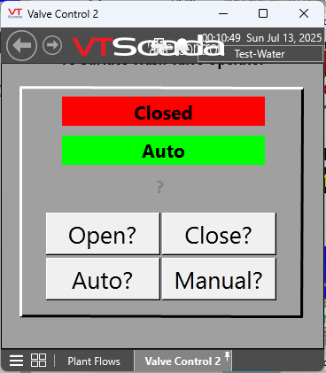

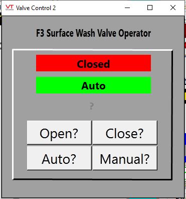

I have created small popup pages for controlling pumps and gate valves, etc. In the Application Configuration Display Properties, I have turned off all Title Bar and Task Bar decorations for popup pages. This works and looks as expected on the server, but in the thin client, all the decorations are present, seriously distorting the page appearance. Is there a way to turn them off in the thin client? I cannot find it in the documentation - probably because I'm not searching correctly. Here are examples:
From the server.
6873353059da7
From the thin client.
687335303ecc5

I should have figured this out myself, but thanks to Victor in tech support for pointing it out.
This issue is resolved using a "Realm Display Setup" tag. I had created one but failed to go through all the tabs. The "Windowed Page Style" tab sets these parameters.
I should have figured this out myself, but thanks to Victor in tech support for pointing it out. This issue is resolved using a "Realm Display Setup" tag. I had created one but failed to go through all the tabs. The "Windowed Page Style" tab sets these parameters.
