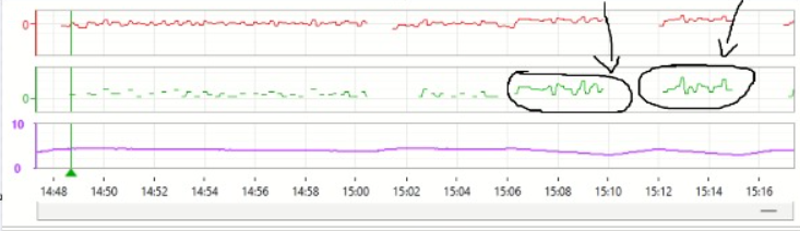

I need to average one point on the graph to another, without exporting all the recorded content, only the selectable content. And I need to export it via Excel. How do I do this? Is there a method?
68b2f31e42038
I need to average just this one pen that is circled:
I need to average one point on the graph to another, without exporting all the recorded content, only the selectable content. And I need to export it via Excel. How do I do this? Is there a method? ![68b2f31e42038](serve/attachment&path=68b2f31e42038) I need to average just this one pen that is circled:
edited Aug 30 '25 at 2:27 pm
You could used a History Statisitcs Tag, or script a filter - see links below:
https://www.vtscada.com/help/Content/D_Tags/Dev_HistoryStats.htm
https://www.vtscada.com/help/Content/Scripting/Tasks/FirstOrderFilter.htm?tocpath=Scripting%7CExamples%20and%20How-To%27s%20for%20Scripting%7CScript%20Code%20Examples%7C_____3
You could used a History Statisitcs Tag, or script a filter - see links below: https://www.vtscada.com/help/Content/D_Tags/Dev_HistoryStats.htm https://www.vtscada.com/help/Content/Scripting/Tasks/FirstOrderFilter.htm?tocpath=Scripting%7CExamples%20and%20How-To%27s%20for%20Scripting%7CScript%20Code%20Examples%7C_____3

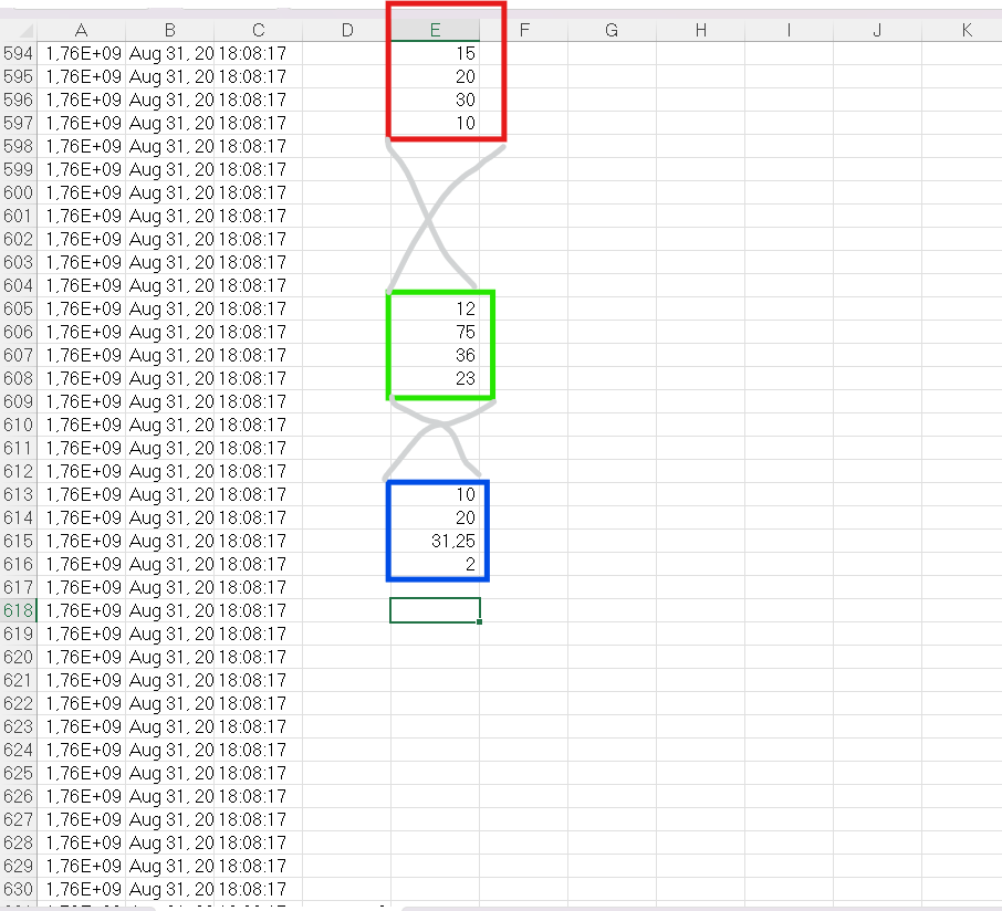

So, let's go... I need the average to be cyclical. I noticed that this "Historical Statistics" tag calculates the average of the entire variable. It's like going from "point A" to "point B" = average (A and B). Then, it will present another cycle... "point C" to "point D," and so on.
The value of this average will be generated by Excel. I'll take some random numbers as an example, so you can visualize.
Cycle 1 (red) = Average (15, 20, 30, 10) = 18.75
No values ​​(values ​​zero and less than 0 do not appear).
indicated in gray.
Cycle 2 (green) = Average (12, 75, 36, and 23) = 36.5
No values ​​(values ​​zero and less than 0 do not appear) - indicated in gray.
And so on.
And at the end of each cycle, calculate its average. When it reaches 0 or less, it indicates a new cycle.
I'm racking my brain for a solution.
68b63a3ba09cd
So, let's go... I need the average to be cyclical. I noticed that this "Historical Statistics" tag calculates the average of the entire variable. It's like going from "point A" to "point B" = average (A and B). Then, it will present another cycle... "point C" to "point D," and so on. The value of this average will be generated by Excel. I'll take some random numbers as an example, so you can visualize. Cycle 1 (red) = Average (15, 20, 30, 10) = 18.75 No values ​​(values ​​zero and less than 0 do not appear). indicated in gray. Cycle 2 (green) = Average (12, 75, 36, and 23) = 36.5 No values ​​(values ​​zero and less than 0 do not appear) - indicated in gray. And so on. And at the end of each cycle, calculate its average. When it reaches 0 or less, it indicates a new cycle. I'm racking my brain for a solution. ![68b63a3ba09cd](serve/attachment&path=68b63a3ba09cd)
edited Sep 2 '25 at 1:28 am
Note: it is just one variable that is in this cycle. It presents values ​​above 0...and does not present values ​​below zero (negative) and equal to zero (invalid);
