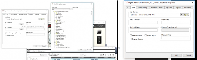

I have watched the video multiple times, I do not have the ability! to open the CIP/ENIP address select because the "Tags" button does not appear next to the Bit 0 address box. the left side is video and the box on right is what I have.
I have watched the video multiple times, I do not have the ability! to open the CIP/ENIP address select because the "Tags" button does not appear next to the Bit 0 address box. the left side is video and the box on right is what I have. [5ade3b9350f4f](serve/attachment&path=5ade3b9350f4f)
If the address assist button is not there, then VTScada is not actually getting a connection to the PLC. Can you send a changeset of your application to us please at support@trihedral.com?
Doug Spurrell
For anybody monitoring, this turned out to be a port segment path configuration issue.
Doug Spurrell
The port segment path is dependent on how the device is configured and is detailed in the documentation on how to figure it out.
See the Connection Tab section of this help file:
https://www.trihedral.com/help/Content/D_Tags/CIP-Driver-Tag.htm
On most of the standard set ups it should be the default [1,0], but on the newer PLCs it's [].
The port segment path is dependent on how the device is configured and is detailed in the documentation on how to figure it out. See the Connection Tab section of this help file: https://www.trihedral.com/help/Content/D_Tags/CIP-Driver-Tag.htm On most of the standard set ups it should be the default [1,0], but on the newer PLCs it's [].
