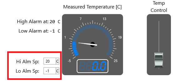

I don't think this example will help with you tag count but it does provide an example of the best way to store variables locally and reference them with an input box.
In the Local Storage Example linked below, the local variables are the high and low alarm setpoints and are stored as Properties. To see them open the application properties, switch from basic to advanced mode, and search for “site*”. You will see the two properties which I am using to store the alarm setpoints.
Local Storage Example App (Copy the address to your browser) - ftp://ftp.trihedral.com/Marketing/DavePub/Local Storage Example.snapshot
I don't think this example will help with you tag count but it does provide an example of the best way to store variables locally and reference them with an input box. In the Local Storage Example linked below, the local variables are the high and low alarm setpoints and are stored as Properties. To see them open the application properties, switch from basic to advanced mode, and search for “site*”. You will see the two properties which I am using to store the alarm setpoints. Local Storage Example App (Copy the address to your browser) - ftp://ftp.trihedral.com/Marketing/DavePub/Local Storage Example.snapshot

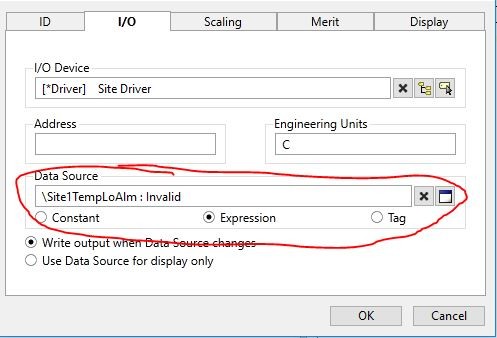

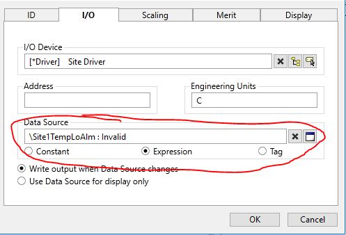

5af20542d6fb5
what is the function of this in the Data Souce of the SP tags?
![5af20542d6fb5](serve/attachment&path=5af20542d6fb5) what is the function of this in the Data Souce of the SP tags?
You'll want to give the property a value: See below for an example of where you can define a value:
5b0c4ad90cf72
You'll want to give the property a value: See below for an example of where you can define a value: ![5b0c4ad90cf72](serve/attachment&path=5b0c4ad90cf72)
