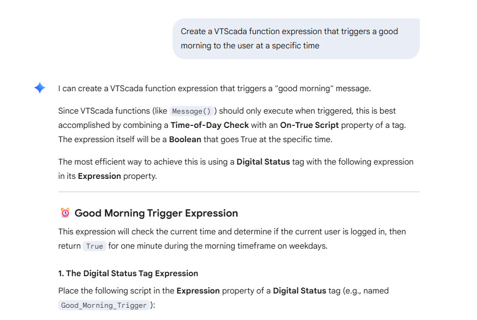

I appreciate your response, and I've started overlooking what you provided. I did come across one part of the help file under Try it...Hello World where it mentions not to experiment within a production application. Does that mean if you have an active running application to not experiment on? I was trying out a few things through the tag browser specifically learning more about how to write expressions through the function editor. I cycled through the available options via the function selection and I have learned a few things, but maybe I find myself confused from writing scripts to writing expressions through an active VTScada application. I then saw that there is a script tag and I tried learning about it, but really don't fully grasp how to use that particular type of tag. The reason I submitted this question was I was recently playing around with Google Gemini by asking AI to create a VTScada function expression that triggers a good morning to the user at a specific time. In my mind, I'm thinking how cool would it be to have your SCADA application greet you in the morning when you clock in. I suppose you could think of it as a Jarvis smile

Gemini's suggested Trigger tag is a good way to show a message at a certain time. You can set the trigger to have the value of TRUE over a period of time and then set a text box's opacity to the value of the trigger tag. As a note, it's always a good idea to wrap a expression in a PickValid() to give a default result in the case that the value is INVALID (NULL).
If you look at a text box opacity and select to link it to a tag or create an expression, you would just need to put the trigger tag in there. If you link it to a tag, don't worry about PickVald()
Gemini's suggested Trigger tag is a good way to show a message at a certain time. You can set the trigger to have the value of TRUE over a period of time and then set a text box's opacity to the value of the trigger tag. As a note, it's always a good idea to wrap a expression in a PickValid() to give a default result in the case that the value is INVALID (NULL). If you look at a text box opacity and select to link it to a tag or create an expression, you would just need to put the trigger tag in there. If you link it to a tag, don't worry about PickVald()
