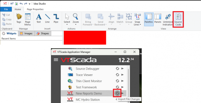

I believe that the default paste is to paste where the mouse is which is often what folks are looking for. If you want to copy a widget or selection of widgets and paste it into the exact spot where you copied it, I think the easiest way might be to open the page source by clicking the source code button. Paste the added widgets there (Note the order of the widgets essentially determines which is in front.
After saving and closing the source code, you can click the Import Files changes button on the VAM to import your custom page source into the application.
I believe that the default paste is to paste where the mouse is which is often what folks are looking for. If you want to copy a widget or selection of widgets and paste it into the exact spot where you copied it, I think the easiest way might be to open the page source by clicking the source code button. Paste the added widgets there (Note the order of the widgets essentially determines which is in front. After saving and closing the source code, you can click the Import Files changes button on the VAM to import your custom page source into the application.

No problem. Just a quick clarification. You are looking for the source code button in the idea studio. The source debugger is great for analyzing and debugging but isn't for editing code.

No problem. Just a quick clarification. You are looking for the source code button in the idea studio. The source debugger is great for analyzing and debugging but isn't for editing code. ![696f80bfb4633](serve/attachment&path=696f80bfb4633)
