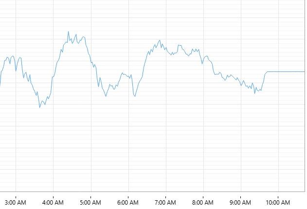

I'm getting about an hour flatline on trends which started with the time change this morning. I have checked times on all servers to make sure they updated and match. Any suggestions? Thanks

I'm getting about an hour flatline on trends which started with the time change this morning. I have checked times on all servers to make sure they updated and match. Any suggestions? Thanks ![69ad8b0a26d9b](serve/attachment&path=69ad8b0a26d9b)
I think that’s normal.

Attempting to view a full day's data (24 hours) on a trend at midnight after the shift to Daylight Savings time (a 23-hour day) can result in an hour-long flat line at the end of the trend.
I think that’s normal. From https://www.vtscada.com/help/Content/Op_UsingVTS/OP_VTScadaAndTime.htm?TocPath=Use%20VTScada%7C_____1 Attempting to view a full day's data (24 hours) on a trend at midnight after the shift to Daylight Savings time (a 23-hour day) can result in an hour-long flat line at the end of the trend.
I had some issues this morning as well, on multi are homed systems , one of the servers didn't adjust and was showing an hour behind from Windows time, witch then I beleive messed up the polling driver and cause a bunch of stuff not to update.
