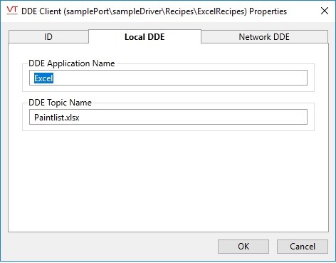

I have a little paint shop example app which uses DDE which you can use as a template. The DDE tag is called ExcelRecipes and it connects to a *.xlsx which lives in the application directory. Another important note is that for DDE, the excel sheet needs to be converted from the typical format to RC format. ie: C2 maps to R2C3
an image of my DDE tag configuration is below:

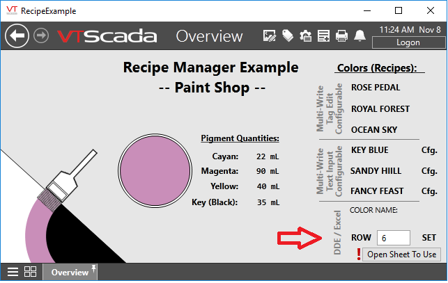

Here is an image of the sample application with the DDE portion highlighted:
