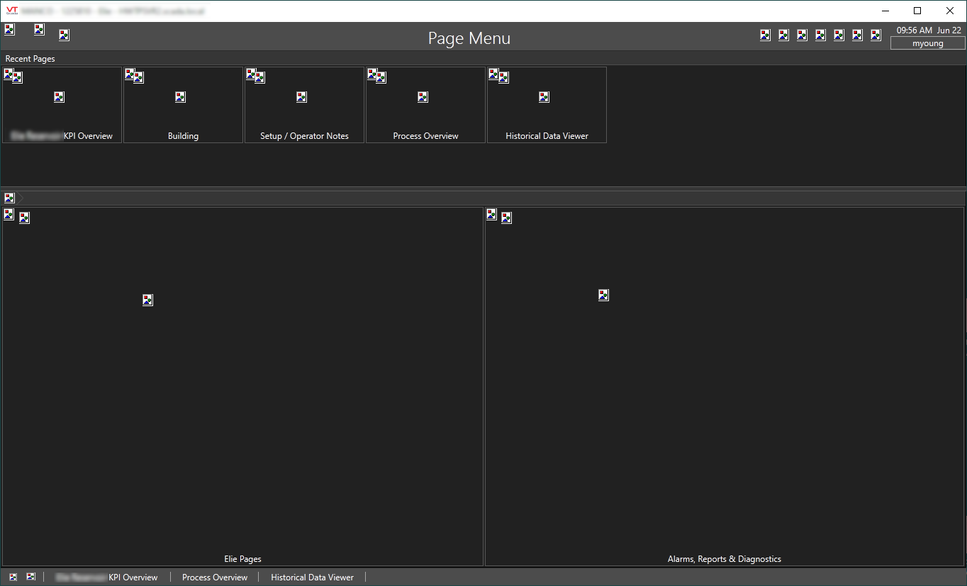

On one of my PC's the VTScada Internet Client stopped updating it's graphics.
Here's what things look like, even after waiting for hours to give things time to load.
6a394f7e8f31a
Has anyone seen this before & solved this problem? If so what did you do?
On one of my PC's the VTScada Internet Client stopped updating it's graphics. Here's what things look like, even after waiting for hours to give things time to load. ![6a394f7e8f31a](serve/attachment&path=6a394f7e8f31a) Has anyone seen this before & solved this problem? If so what did you do?
I suspect a networking issue. Probably something to do with firewalls or HTTPS security certs. We had an issue like this and it ended up being city IT's firewall. They had to troubleshoot which rule and disable it.
Thanks, that's reassuring. So far it's only affecting my laptop which I use to maintain our customers SCADA via VPN. I was worried this issue could spread to our customer's PCs and now I'm less concerned.
Next time I'm on-site I'll physically connect the same laptop to their LAN and see if the problem goes away. Hopefully it's the firewall in our office.
Thanks, that's reassuring. So far it's only affecting my laptop which I use to maintain our customers SCADA via VPN. I was worried this issue could spread to our customer's PCs and now I'm less concerned. Next time I'm on-site I'll physically connect the same laptop to their LAN and see if the problem goes away. Hopefully it's the firewall in our office.

Last week I had the opportunity to try my thin client connection right from the plant LAN with no firewalls to get in the way. That didn't improve things as we'd hoped.
Anyone else have ideas about this? Last week I had the opportunity to try my thin client connection right from the plant LAN with no firewalls to get in the way. That didn't improve things as we'd hoped.
Did you turn your VPN off when on the local network? I had this issue before. Remote VPN was blocked from a firewall rule, and when I tried locally, the laptop still tried to connect through the VPN. After shutting the VPN down, it had no problem on the local network and after locating the right firewall rule, remote access was restored.
Yes. I was on the same LAN as the workstation serving the thin clients with no VPN software running.
Thanks for the suggestion. Didn't work for me but it might help others.
