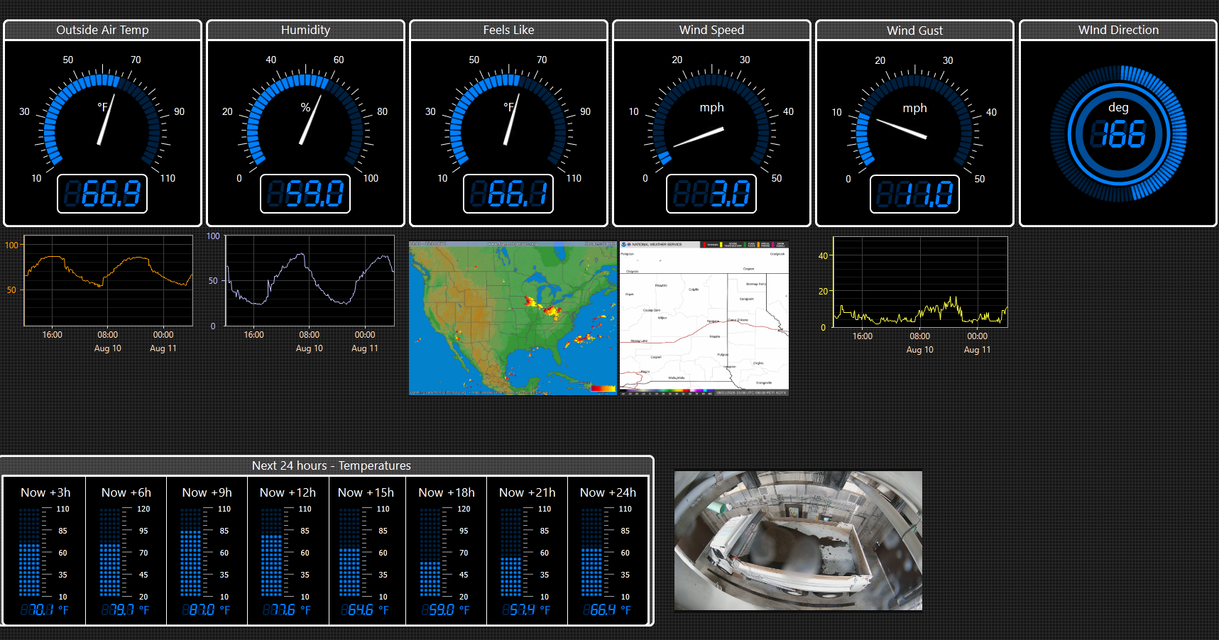

Thanks Dave.
That worked really well. Almost too easy, but there is no way I would have worked that out - thanks for the CONCAT glue to make it work.
Put together a simple weather station as a self learning experience, but the crew here really like it.
Lighting and rain radar and an example of a local CCTV camera to show the art of the possible.

Thanks Dave. That worked really well. Almost too easy, but there is no way I would have worked that out - thanks for the CONCAT glue to make it work. Put together a simple weather station as a self learning experience, but the crew here really like it. Lighting and rain radar and an example of a local CCTV camera to show the art of the possible. ![6a7b3d5b8a094](serve/attachment&path=6a7b3d5b8a094)
