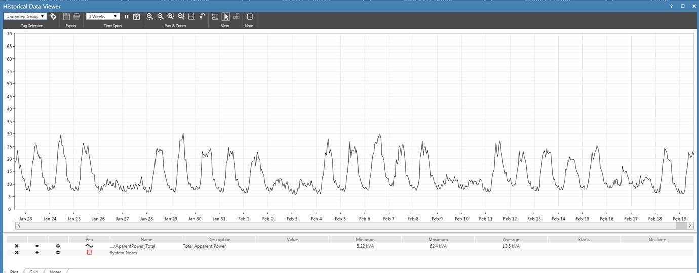

This is what I see. Print ans Export grayed out
5c6d6ef5b0962
This is what I see. Print ans Export grayed out ![5c6d6ef5b0962](serve/attachment&path=5c6d6ef5b0962)
Are you doing this in an Anywhere client? Web browsers do not have direct access to hardware so the print function cannot work. It would be grayed out. All you can do is use the screen print functionality in the browser itself.
