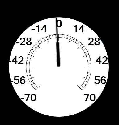

Well, I finally figured it out. It ain't pretty, but it works. Below are an image and the code. As they say, "Form follows Function". Got the Function, got to work on the Form. The tag the dial references is an Analog Status with a range of -70 to 70.

Well, I finally figured it out. It ain&#039;t pretty, but it works. Below are an image and the code. As they say, &quot;Form follows Function&quot;. Got the Function, got to work on the Form. The tag the dial references is an Analog Status with a range of -70 to 70. ![5c6f28d20dd69](serve/attachment&amp;path=5c6f28d20dd69) ```` [ Title = &quot;TestPage&quot;; Color = &quot;&lt;FF000000&gt;&quot;; ] Main [ Return(Self); GUITransform(1454, 488, 1863, 83, 1, 1, 1, 1, 1 { Scaling }, 0, 0 { Movement }, 1, 0 { Opacity, Reserved }, 0, 0, 0 { Selectability }, Scope(\Code, &quot;UserMethods&quot;, TRUE)\Group_e5bdae37_14b2_48f2_b655_359a310ec695(Scope(\VTSDB, &quot;qdp96j{2Lr\8d-@$7((6c\4ogg.^shb-&quot;, TRUE), Scope(\VTSDB, &quot;qdp96j{2Lr\8d-@$7((6c\3)0%_--mi$&quot;, TRUE))); GUIEllipse(172, 561, 496, 237, 1, 1, 1, 1, 1 { Scaling }, 0, 0 { Movement }, 1, 0 { Visibility, Reserved }, 0, 0, 0 { Selectability }, Brush(&quot;&lt;FFFFFFFF&gt;&quot;, 0, 1), Pen(&quot;&lt;FF000000&gt;&quot;, 1, 1)); GUITransform(172, 561, 496, 237, 1, 1, 1, 1, 1 { Scaling }, 0, 0 { Movement }, 1, 0 { Visibility, Reserved }, 0, 0, 0 { Selectability }, Scope(\Code, &quot;MeterParts&quot;, TRUE)\RadialIndicator(Scope(\VTSDB, &quot;u!3dL5w3#x\s5_-s4!@^j\)0maqt5ck&amp;&quot;, TRUE), \ImageParmSet(&quot;Bitmaps\Meter Parts\Indicators\Radial\Needle2.png&quot;, &quot;&lt;FF000000&gt;&quot;, Invalid, Invalid, 0, 1, 1, 1, 0, 1, 0, 0), 0, 0, 0, 135, 0, 1, 1, 1, 1, 0, 0, 0, 0, 70, 0, &quot;&lt;FFFFFFFF&gt;&quot;)); GUITransform(172, 561, 496, 237, 1, 1, 1, 1, 1 { Scaling }, 0, 0 { Movement }, 1, 0 { Visibility, Reserved }, 0, 0, 0 { Selectability }, Scope(\Code, &quot;MeterParts&quot;, TRUE)\RadialIndicator(Scope(\VTSDB, &quot;u!3dL5w3#x\s5_-s4!@^j\)0maqt5ck&amp;&quot;, TRUE), \ImageParmSet(&quot;Bitmaps\Meter Parts\Indicators\Radial\Needle2.png&quot;, &quot;&lt;FF000000&gt;&quot;, Invalid, Invalid, 0, 1, 1, 1, 0, 1, 0, 0), 0, 0, 225, 0, 0, 1, 1, 1, 1, 0, 0, 0, -70, 0, 0, &quot;&lt;FFFFFFFF&gt;&quot;)); GUITransform(172, 561, 496, 237, 1, 1, 1, 1, 1 { Scaling }, 0, 0 { Movement }, 1, 0 { Visibility, Reserved }, 0, 0, 0 { Selectability }, Scope(\Code, &quot;MeterParts&quot;, TRUE)\RadialLegend(Invalid, 0, 135, 6, Scope(\VTSDB, &quot;MeterFont&quot;, TRUE), &quot;&lt;FF000000&gt;&quot;, 0, 0, 0, 0, 70, 1)); GUITransform(172, 561, 496, 237, 1, 1, 1, 1, 1 { Scaling }, 0, 0 { Movement }, 1, 0 { Visibility, Reserved }, 0, 0, 0 { Selectability }, Scope(\Code, &quot;MeterParts&quot;, TRUE)\RadialLegend(Invalid, 225, 0, 6, Scope(\VTSDB, &quot;MeterFont&quot;, TRUE), &quot;&lt;FF000000&gt;&quot;, 0, 0, 0, -70, 0, 1)); GUITransform(228, 504, 439, 293, 1, 1, 1, 1, 1 { Scaling }, 0, 0 { Movement }, 1, 0 { Visibility, Reserved }, 0, 0, 0 { Selectability }, Scope(\Code, &quot;MeterParts&quot;, TRUE)\SimpleRadialScale(6, 4, 0.1, 0.05, 1, 1, 225, 0, 0, 9, &quot;&lt;FF000000&gt;&quot;, &quot;&lt;FF000000&gt;&quot;)); GUITransform(228, 504, 439, 293, 1, 1, 1, 1, 1 { Scaling }, 0, 0 { Movement }, 1, 0 { Visibility, Reserved }, 0, 0, 0 { Selectability }, Scope(\Code, &quot;MeterParts&quot;, TRUE)\SimpleRadialScale(6, 4, 0.1, 0.05, 1, 1, 0, 135, 0, 9, &quot;&lt;FF000000&gt;&quot;, &quot;&lt;FF000000&gt;&quot;)); ] ````
