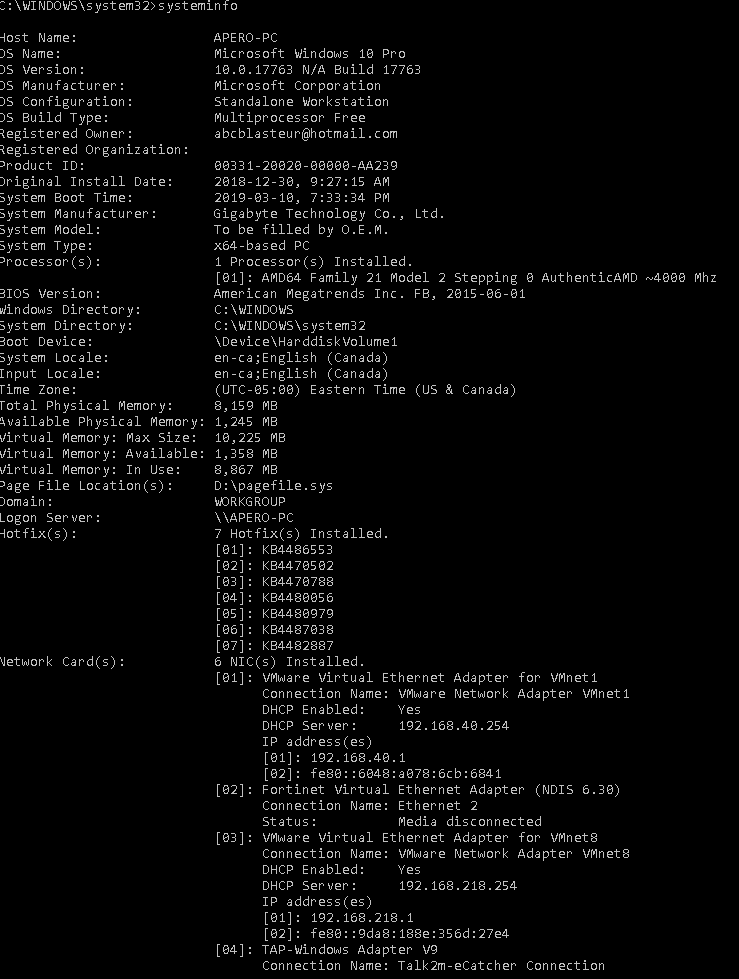

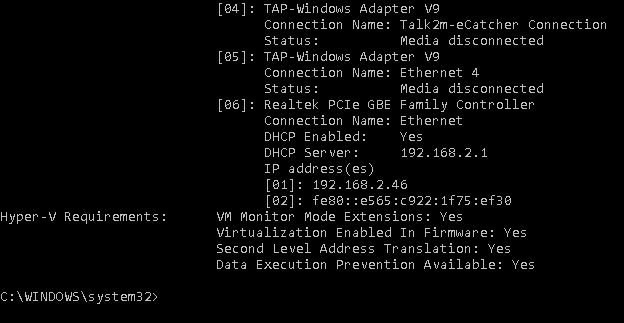

I've tried 6 times to install VTS 11.3.23 yesterday on a Windows 10 Pro PC. I've attache my PC Systeminfo.5c86fd97e5430
5c86fd97ef291

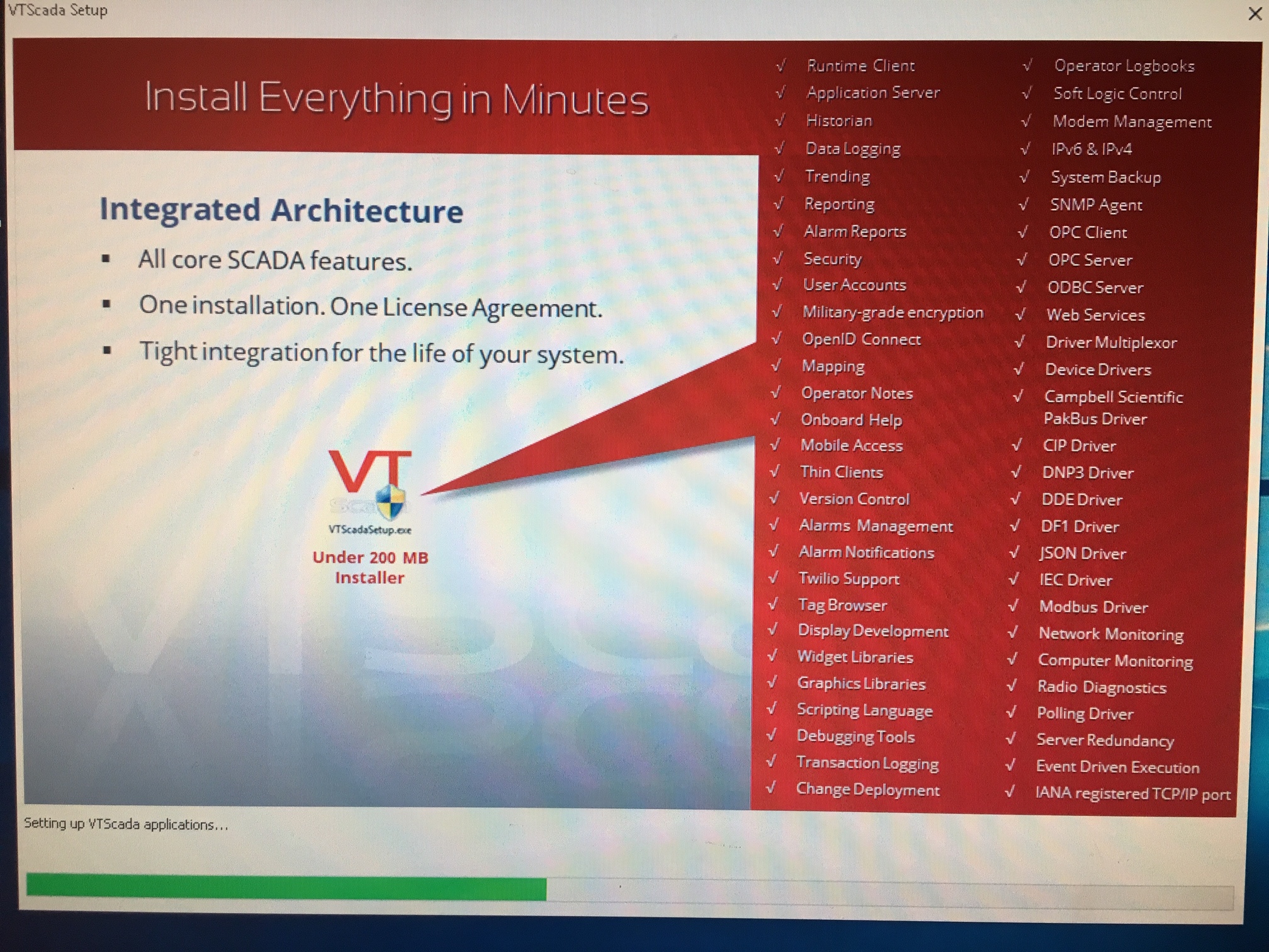

1- First try, I download the executable from the VTS web site, right click and run as an administrator. I've selected the VTS Light version 64bits. The installation freeze and the whole PC. It freezes at 15%, and I went for lunch before restarting the PC. The PC did not start. I had no option but to load an earlier backup.
2- Reload the windows backup and launch the installation again. It went up until I see application remaining 7 and then crash. Same parttern. I've to load a backup can't start the PC.

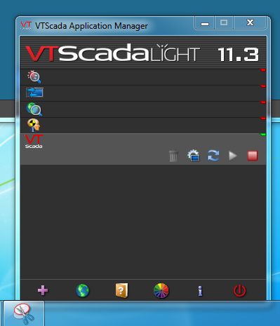

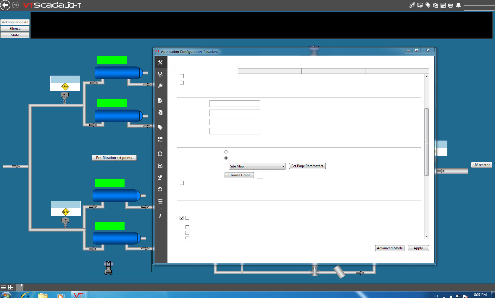

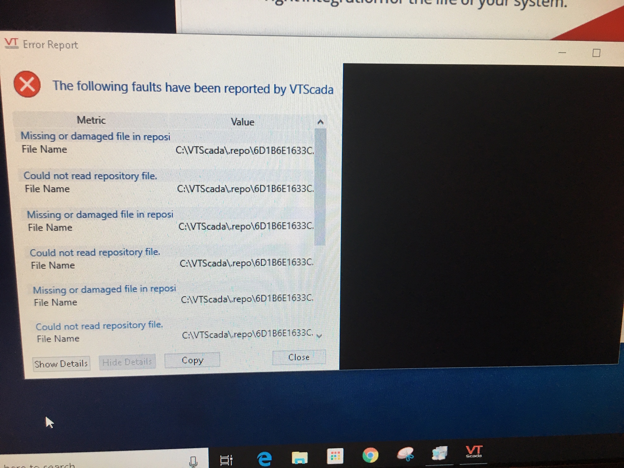

6- I've started a Windows 7 vitrual machine and install the VTS 11.3.23 software and it works!! Oh yess, I've start the application (double click on the changeset) and I don't have any text shown. There's also no text in the VTS application manager. See picture.
5c86fad96b5d8 5c86fec092231
What's wrong with my PC? Everything works well normally... I've given up after 6h of PC reset and failure.
I've tried 6 times to install VTS 11.3.23 yesterday on a Windows 10 Pro PC. I've attache my PC Systeminfo.![5c86fd97e5430](serve/attachment&path=5c86fd97e5430) ![5c86fd97ef291](serve/attachment&path=5c86fd97ef291) - - 1- First try, I download the executable from the VTS web site, right click and run as an administrator. I've selected the VTS Light version 64bits. The installation freeze and the whole PC. It freezes at 15%, and I went for lunch before restarting the PC. The PC did not start. I had no option but to load an earlier backup. 2- Reload the windows backup and launch the installation again. It went up until I see application remaining 7 and then crash. Same parttern. I've to load a backup can't start the PC. 3- I've done the same thing, but before starting the installation, I've disabled the windows user control feature and the windows virus protection. No chance, the PC crash and I've to reload a backup. 4- I've tried with 32bits VTS version. Same thing. 5- I tried to install VTS 11.2.3, thinking it's the version. No chance... ![5c86fad9bc2c8](serve/attachment&path=5c86fad9bc2c8) ![5c86fad9d88d3](serve/attachment&path=5c86fad9d88d3) 6- I've started a Windows 7 vitrual machine and install the VTS 11.3.23 software and it works!! Oh yess, I've start the application (double click on the changeset) and I don't have any text shown. There's also no text in the VTS application manager. See picture. ![5c86fad96b5d8](serve/attachment&path=5c86fad96b5d8) ![5c86fec092231](serve/attachment&path=5c86fec092231) What's wrong with my PC? Everything works well normally... I've given up after 6h of PC reset and failure.

I think we can help you with this. You installer issue on the Windows 10 machine is likely due to an over-aggressive virus scanner. I'd suggest trying the installer, as an admin, with the virus scanner disabled.
On the Windows 7 screen, if you get that machine up-to-date, your text will appear smile
Hope this helps, let us know if you continue to have issues with the installer.

Can I email you a location to place a zipped version of the partially installed VTScada directories (one is likely C:\VTScada*. and the other is likely C:\Program Files\Trihedral\VTScada\.*)? We don't have any other reports of this issue so I'd like to raise a support request to see if our development folks can help you out on this.
PS: sorry I missed some of your previous notes They seemed to get blended into the images for some reason but I have since read them and see you had already tried with your anti-virus disabled.
Can I email you a location to place a zipped version of the partially installed VTScada directories (one is likely C:\VTScada\*.* and the other is likely C:\Program Files\Trihedral\VTScada\*.*)? We don't have any other reports of this issue so I'd like to raise a support request to see if our development folks can help you out on this. PS: sorry I missed some of your previous notes They seemed to get blended into the images for some reason but I have since read them and see you had already tried with your anti-virus disabled.

Our development group has requested a few more bits of info on this. They would like to know how much drive space you have remaining and would like you to run a disk check to ensure there isn't a disk error. As I noted earlier, this is the only instance of this issue we have heard of and they are seeing some missing files which should have been installed before files which are in the directory you sent.

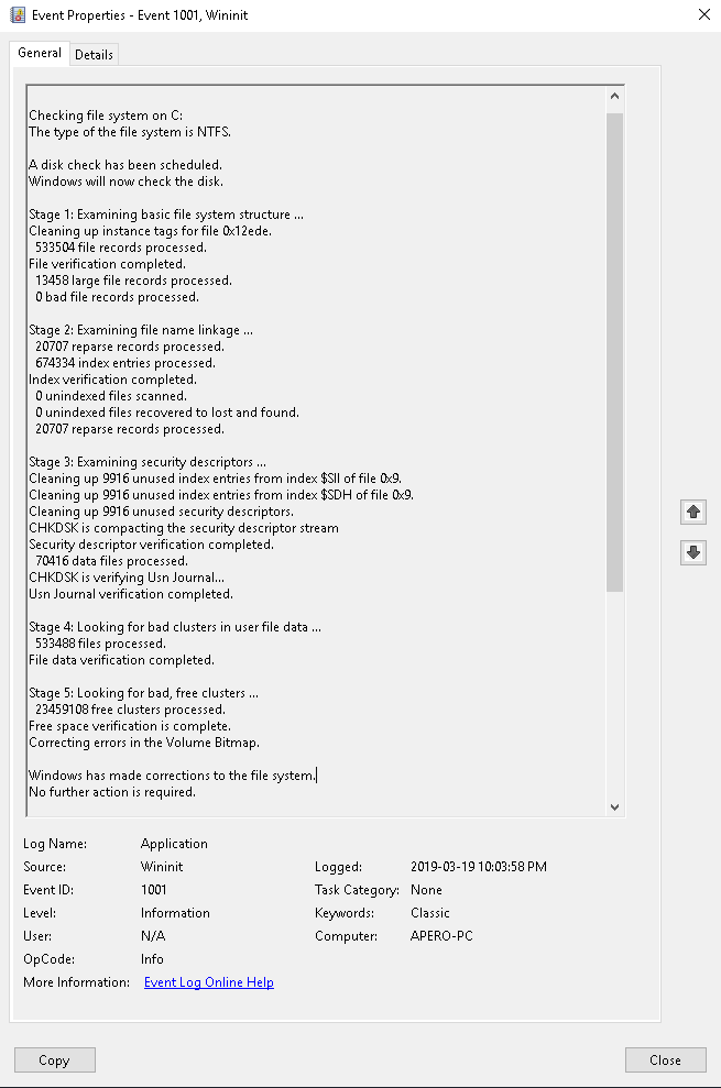

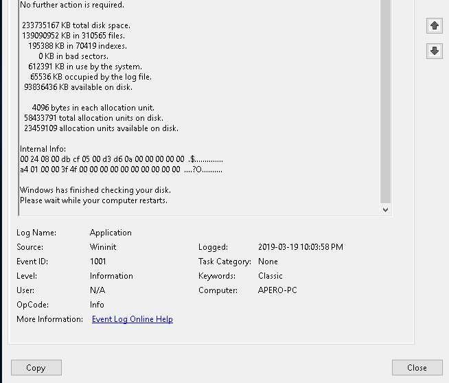

Hi Dave,
Here's the report :
5c91a427b7307
5c91a427b96e1
Do you want me to delete C:\VTScada and C:\Program Files\Trihedral then retry a clean VTS installation ?
Hi Dave, Here's the report : ![5c91a427b7307](serve/attachment&path=5c91a427b7307) ![5c91a427b96e1](serve/attachment&path=5c91a427b96e1) Do you want me to delete C:\VTScada and C:\Program Files\Trihedral then retry a clean VTS installation ?
Yes, deleting the directories may help. I'd also suggest removing the software\trihedral registries. I'll add your notes, above, to the support case.

Every time the PC freeze when the installation is at Application remaining : 7. Then I've to restore to a previous checkpoint, windows won't start. I've let the PC froze 5 hours hopping it will finish the installation.
See into the incoming folder the .zip file called "2019-03-24_VTS_LOGS_PL.zip" where you can find the VTS installation folder, the SFC log and a picture where it froze.
Thanks for your help, but I can't get it done.
