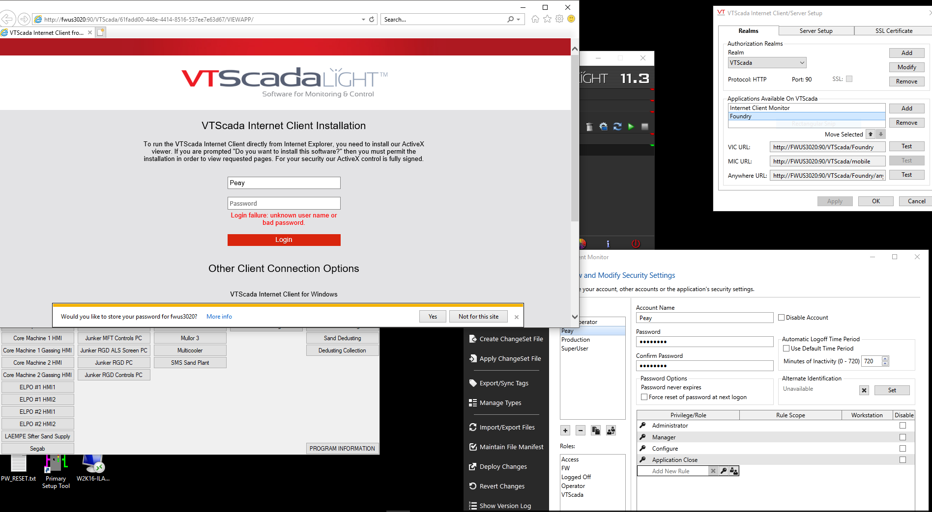

I cannot get my VIC to work.5cd06ee6cd464
I don't know if its my network here at the plant or what.
I cannot get my VIC to work.![5cd06ee6cd464](serve/attachment&path=5cd06ee6cd464) I don't know if its my network here at the plant or what.

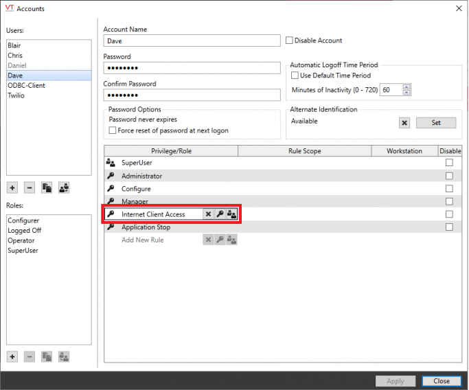

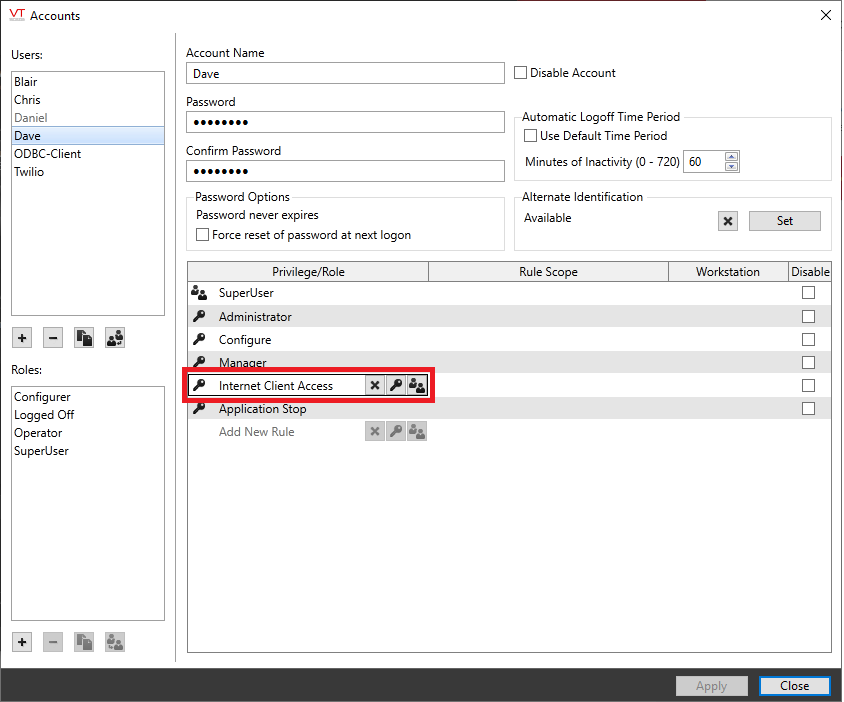

You need to add the Internet Client privilege to your user.
5cd071c4a6b8b
You need to add the Internet Client privilege to your user. ![5cd071c4a6b8b](serve/attachment&path=5cd071c4a6b8b)
