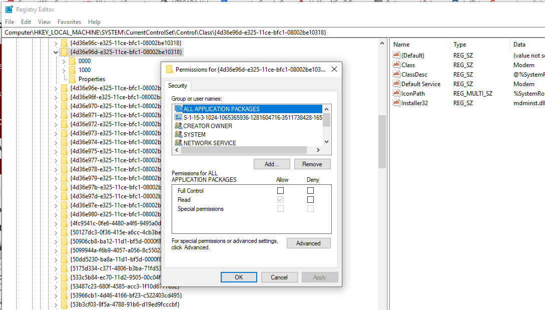

We installed the update here and tested against the Multitech modem. We did have to re-install VTScada and also tweak the modem registry setting to add back in the Network Service user. The registry key is at -
Computer\HKEY_LOCAL_MACHINE\SYSTEM\CurrentControlSet\Control\Class{4d36e96d-e325-11ce-bfc1-08002be10318}

We installed the update here and tested against the Multitech modem. We did have to re-install VTScada and also tweak the modem registry setting to add back in the Network Service user. The registry key is at - Computer\HKEY_LOCAL_MACHINE\SYSTEM\CurrentControlSet\Control\Class\{4d36e96d-e325-11ce-bfc1-08002be10318} ![5d08cf170d88f](serve/attachment&path=5d08cf170d88f) But, it did work. If it turns pout to be a bigger issue, we will keep it updated here. Remember, we don't handle the modem or voice in the same manner as WIN911. So a problem or a even a fix for them, may not have the same impact on us. But it is nice to get a heads up like this so we can get ahead of it. Thank you!

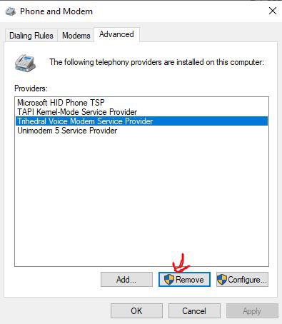

As an additional note here, I just had a customer computer that had this update applied today. They had already installed important bios updates from dell as well (which would be another useful step), and I was able to get the modem working again by following this process (and no reinstall was required):
  1. Go into Control Panel and open 'Phone and Modem', and go to the Advanced tab
  2. Select the Trihedral entry and remove it

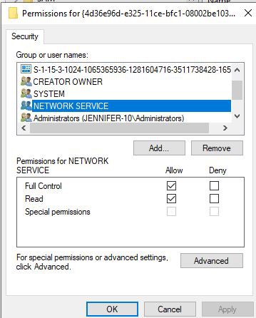

  3. Go into the registry key Doug mentioned previously and open the permissions on it5d3b2de9e8d08
  4. Add NETWORK SERVICE with Full Control
  5. Go back into 'Phone and Modem' and add the Trihedral entry back in on the Advanced tab

As an additional note here, I just had a customer computer that had this update applied today. They had already installed important bios updates from dell as well (which would be another useful step), and I was able to get the modem working again by following this process (and no reinstall was required): 1. Go into Control Panel and open 'Phone and Modem', and go to the Advanced tab 2. Select the Trihedral entry and remove it ![5d3b2db4eadbc](serve/attachment&path=5d3b2db4eadbc) 3. Go into the registry key Doug mentioned previously and open the permissions on it![5d3b2de9e8d08](serve/attachment&path=5d3b2de9e8d08) 4. Add NETWORK SERVICE with Full Control 5. Go back into 'Phone and Modem' and add the Trihedral entry back in on the Advanced tab 6. In your VTScada application, open the properties for that modem tag and add a character to the end of the line name (any character, this is just used to track which modems share a phone line) and select 'OK' to save that change 7. If desired, go back and delete the extra character from the line name. Either way, everything should be working again 8. If you're nervous about making changes in the registry, reinstalling VTScada is another option that will do all of this for you (it just requires stopping VTScada and your application shortly while you run the installer)
