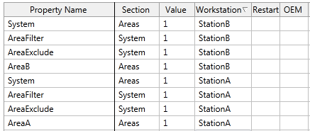

Yes, that's what we are trying to do. Just unsure on how/if any Advanced server configuration is needed to do this, because we will end up with 9 local nodes and 2 servers. But in setting up the first local node through tag area filtering, we find there is something missing, as we can't get our custom property to say: "AreaA, Areas, 1, StationA" as in the photo below.

Yes, that's what we are trying to do. Just unsure on how/if any Advanced server configuration is needed to do this, because we will end up with 9 local nodes and 2 servers. But in setting up the first local node through tag area filtering, we find there is something missing, as we can't get our custom property to say: "AreaA, **Areas**, 1, **StationA**" as in the photo below. ![5d658858ebedb](serve/attachment&path=5d658858ebedb)
All of the elements in the first columns tables are just text strings. You do not have to obey the drop down lists in the Insert dialog.
If StationA/StationB are missing from the drop down list, they are just probably not in the workstation list yet.
I would do all the property configuration first (for licensing limitations on remote nodes), then install VTS on the nodes, pull the workstation from the server, then setup alarm area filtering, then customize the server list as required.
All of the elements in the first columns tables are just text strings. You do not have to obey the drop down lists in the Insert dialog. If StationA/StationB are missing from the drop down list, they are just probably not in the workstation list yet. I would do all the property configuration first (for licensing limitations on remote nodes), then install VTS on the nodes, pull the workstation from the server, then setup alarm area filtering, then customize the server list as required.
