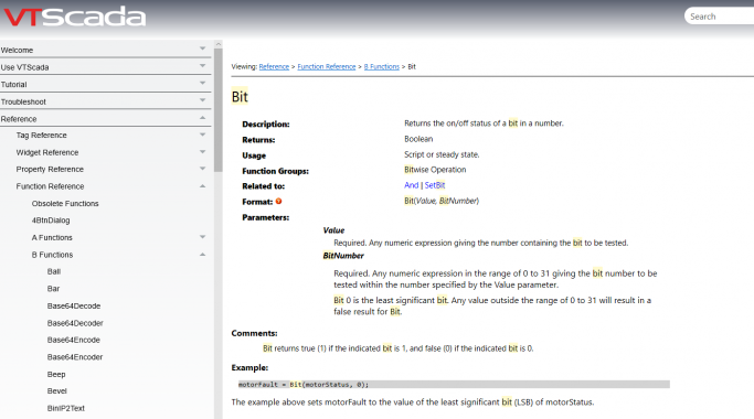

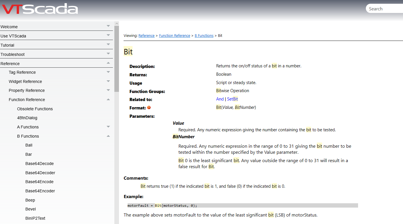

This is how I found to do it
1) create a numeric calculation tag
2) in the expression area put the following expression Bit([Value],x) where "value" is the register you are reading and "x" is the bit you want to examine. Remember it is zero based, so put 0 if you want the first bit and so on. If you press F1 to open the help and search for Scripts, you can find a lot of useful info like shown in the screenshot. Good luck

This is how I found to do it 1) create a numeric calculation tag 2) in the expression area put the following expression Bit([Value],x) where "value" is the register you are reading and "x" is the bit you want to examine. Remember it is zero based, so put 0 if you want the first bit and so on. If you press F1 to open the help and search for Scripts, you can find a lot of useful info like shown in the screenshot. Good luck ![5e0ab90392f0d](serve/attachment&path=5e0ab90392f0d)
