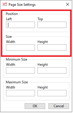

Just populate the info in the screenshot below. You can edit this from the idea studio.
Reserve some space for popups in your HMI layout (an area of low importance on each page) and you can force popups to spawn in that space.
5e2613415bf9e
Just populate the info in the screenshot below. You can edit this from the idea studio. Reserve some space for popups in your HMI layout (an area of low importance on each page) and you can force popups to spawn in that space. ![5e2613415bf9e](serve/attachment&path=5e2613415bf9e)

Thanks for your response Dave. I've played around with your idea already. The issue is that it is still a Popup that needs to be manually closed and is draggable. Multiple popups are allowed within the system but only one faceplate should ever be active and dependent on the currently clicked on display element type. If a different element is selected, the current faceplate should disappear and the appropriate faceplate should appear in its place.
