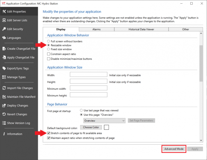

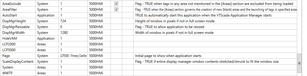

Looking for the best way to configure resolutions between 10 pack applications and various client size displays. We have 15" 1024x768 HMIs at our panels, these using the 10 packs so we can filter by panel number. Then we have 27" and 32" monitors in our operator room running the main application on the VIC, and then programmer staff use 24" monitors.
Here is a look at how we have one of the HMIs configured, and we have done something similar with the main scada application to accommodate the operators. Just wondering if there is a better way. Thanks.

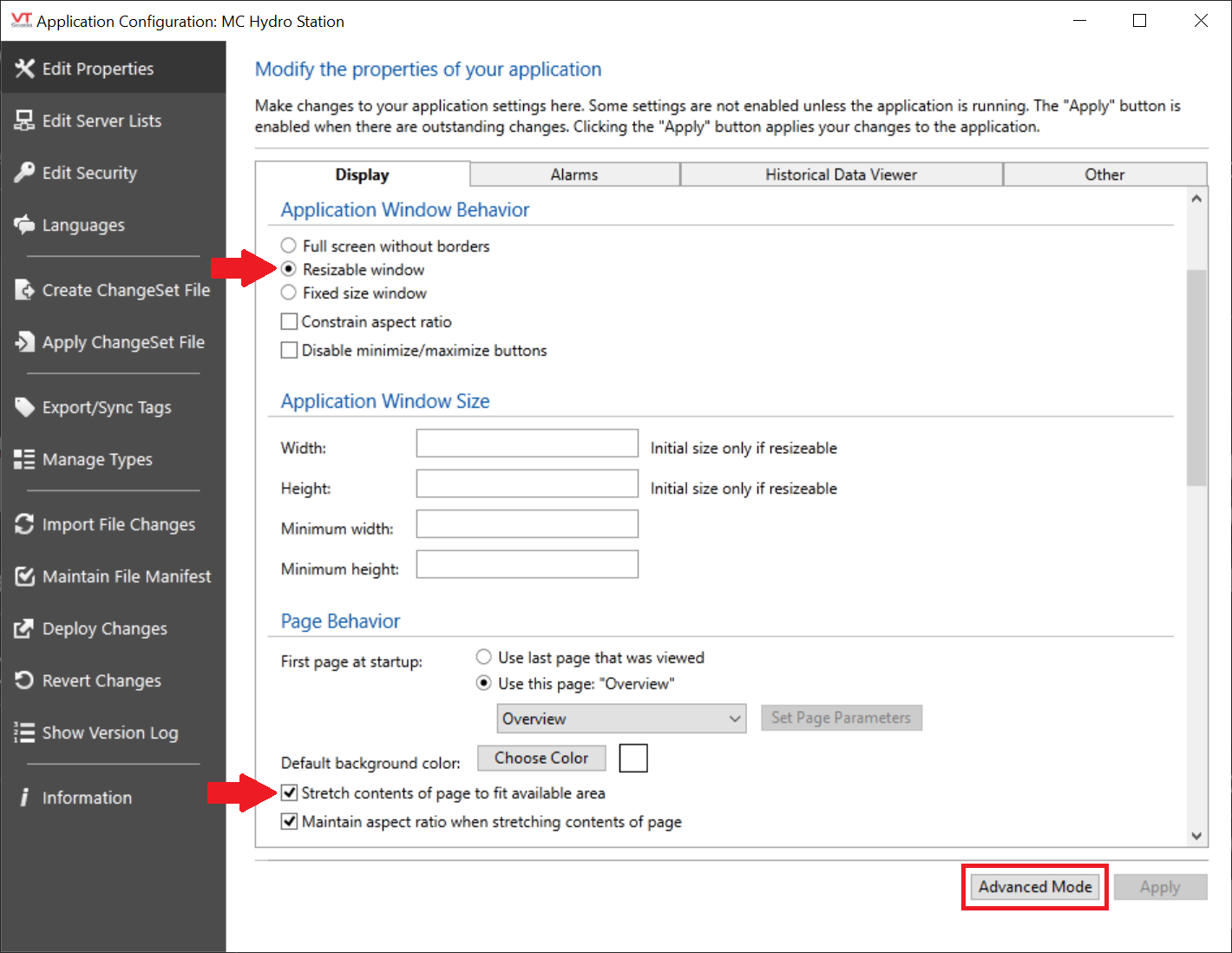

You'll want to view the settings in basic mode and set the following:
If the screen icons are too small, then set the width and height for the initial and minimum size until things render at a scale you are happy with. I hope that helps.

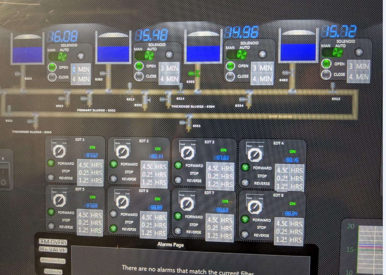

We have tried this, while it looks good on the 24"/27"/32" monitors, this is what happens on the 15" HMIs:5e289dfc7465c
You can see the numeric entry and navigation button widgets get jumbled.
