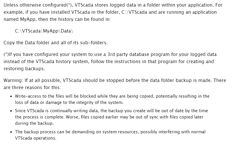

I attached an excerpt from the help files, but I would like to discuss it for a second.
5e4c9236a66ab
file:///C:/VTScada/VTSHelp/Content/D_Tools/Dev_Backups.htm
If there is a single application on site, and we need a backup solution that is automatic AND shutting down and restarting the application isn't possible, is using windows file history an acceptable method for continuous backup?
Has there been issues in the past, and or suspected issues with restoring backups?
Assume we are using the VTScada history system.
Thanks,
JM

No, because the Windows file history is susceptible to the same problems that the entire file system is exposed to (corrupt configuration, bad Microsoft updates, hard drive failure, accidental deletion, malicious users).
Use an enterprise-proven live snapshot technology like Acronis or Veeam and back up both the entire computer configuration and history files to an external hard drive or network attached storage.
Alternatively, you can just use a virtualization technology, keep your SCADA computer as a virtual machine and take VM snapshots.
Keep at least 2 or 3 full backups files (independent images). Ideally, a backup should be kept offline for ransomware protection.
No, because the Windows file history is susceptible to the same problems that the entire file system is exposed to (corrupt configuration, bad Microsoft updates, hard drive failure, accidental deletion, malicious users). Use an enterprise-proven live snapshot technology like Acronis or Veeam and back up both the entire computer configuration and history files to an external hard drive or network attached storage. Alternatively, you can just use a virtualization technology, keep your SCADA computer as a virtual machine and take VM snapshots. Keep at least 2 or 3 full backups files (independent images). Ideally, a backup should be kept offline for ransomware protection.
edited Feb 19 '20 at 3:26 am
Windows File History does use Shadow Copy technology and does work to backup your VTScada directory including older history. This is what I use on my work computer and it has worked very well for me.
Note that the drive where the files are copied to up does, by default, appear in the list of drives so it may be susceptible to viruses or corruption. In my case, I manually plug in the backup drive each day I am in the office to allow the backup to occur then unplug the drive once the backup is complete.
This said, if you really care about your data, a VTScada backup server and good IT practices is by far the best way to increase uptime and reduce the risk of data loss. In an ideal world, a user will have a backup server and also create a regular backup of the VTScada directory on a removable drive as well.
Windows File History does use Shadow Copy technology and does work to backup your VTScada directory including older history. This is what I use on my work computer and it has worked very well for me. Note that the drive where the files are copied to up does, by default, appear in the list of drives so it may be susceptible to viruses or corruption. In my case, I manually plug in the backup drive each day I am in the office to allow the backup to occur then unplug the drive once the backup is complete. This said, if you really care about your data, a VTScada backup server and good IT practices is by far the best way to increase uptime and reduce the risk of data loss. In an ideal world, a user will have a backup server and also create a regular backup of the VTScada directory on a removable drive as well.
