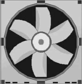

How can I make rotation in any shape.
For ex. I have draw one fan symbol in idea studio.
I want to rotate this shape in clockwise direction.
How can I do this in VTScada.
Please guide me through steps to rotate any shape in VTScada idea studio.

I want to do making the object turn in response to changing conditions.
Like if my digital status tag value (Pump1 Running) becomes 1 then I want to rotate my pump image.
I have drawn one pump image into the idea studio.
How can I make this image (pump) turn when Digital status tag value changes to 1?

Dear Andrew,
Can you please help me to make the rotation of the pump?
I'm making one screen and in this, I need to show pump rotate when the Pump running status tag value goes ON(1) & OFF(0).
I have drawn a pump like below in the idea studio.
609a4eb232dc4
I want to show pumps 3 blades are rotating in CCW counter-clockwise direction.
Dear Andrew, Can you please help me to make the rotation of the pump? I'm making one screen and in this, I need to show pump rotate when the Pump running status tag value goes ON(1) & OFF(0). I have drawn a pump like below in the idea studio. ![609a4eb232dc4](serve/attachment&path=609a4eb232dc4) I want to show pumps 3 blades are rotating in CCW counter-clockwise direction.
Hi Ketul,
If you want to continuously rotate an image while a condition remains true, then the approach described here is NOT the way to do it...
https://www.vtscada.com/help/Content/D_DrawAndEdit/D_Rotation.htm
You should instead use this widget.
https://www.vtscada.com/help/Content/D_Widgets/Dev_AnimatedBitmapWidget.htm?Highlight=animation
It involves creating a series of images, one for each frame of the animation. Then it uses tag data to start and stop the animation and set its speed.
