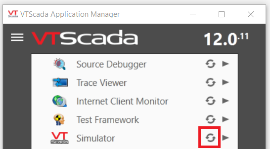

Most application updates can be imported without any tricks or a restart by going to the VTScada Application Manager window and clicking the "Import File Changes" button for the application you have updated. Can you confirm that you have already tried this and a restart is required?
5ed7ecafc3458
Most application updates can be imported without any tricks or a restart by going to the VTScada Application Manager window and clicking the "Import File Changes" button for the application you have updated. Can you confirm that you have already tried this and a restart is required? ![5ed7ecafc3458](serve/attachment&path=5ed7ecafc3458)
Dave, yes, I clicked on that Import File Changes button and a pop up shows up asking to restart the application. The changes were made on a .SRC file for the custom report.
Dave, yes, I clicked on that **Import File Changes** button and a pop up shows up asking to restart the application. The changes were made on a .SRC file for the custom report.
