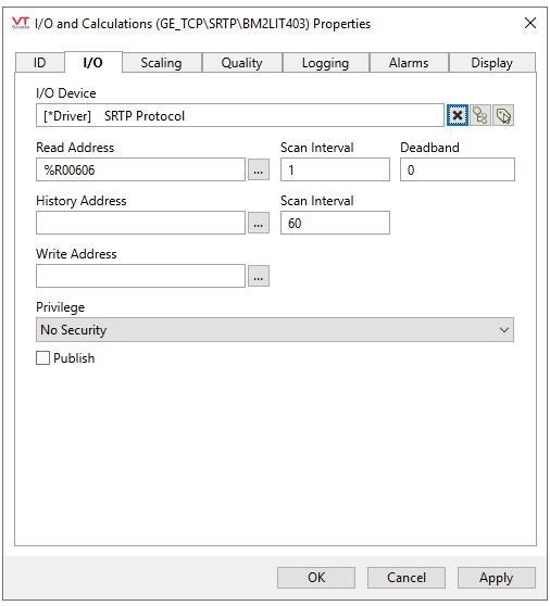

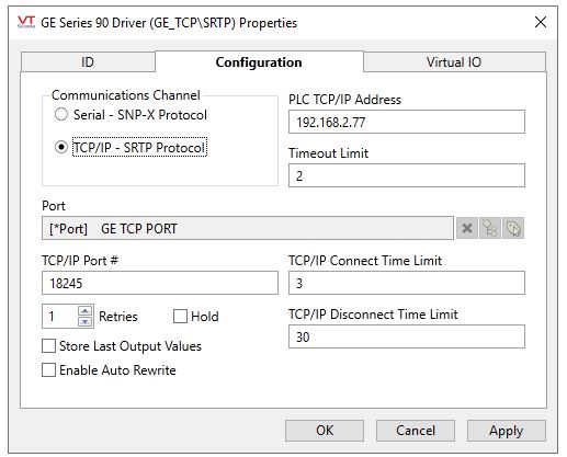

I've a RX3I CPU331 and I've installed (latest VTScada version 12.02smile on a Windows 2019 server. I add the GE Driver configured has shown in the picture with the default port founded in the help file. I add 1 analog points %R606 which is a level moving in the PLC, but i don't see anything on the SCADA screen.

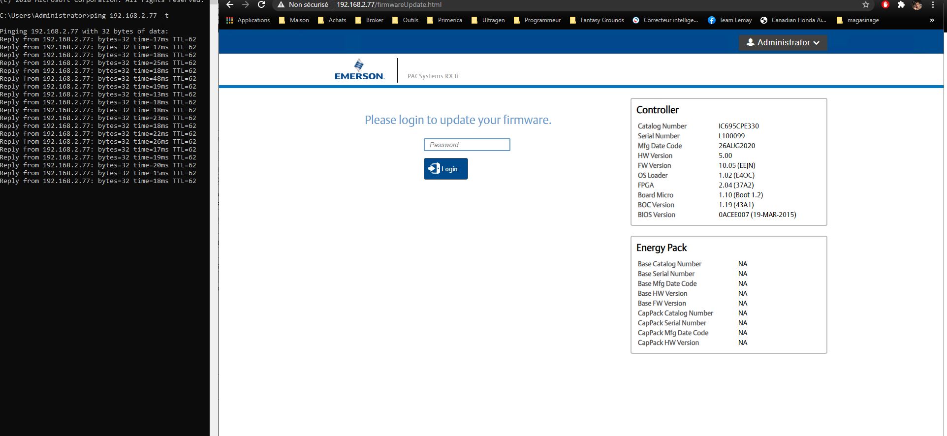

Everything "Ping" and I enter in the web server of the RX3I, get online with the PLC, but VTScada isn't reading the point.

First, remove the TCP tag. The GE driver has TCP built into it so the TCP port tag is not necessary. In fact it may actually be causing a problem if the device won't accept multiple connections from the same IP on the same port.
Check the server list. Is the computer you are working on in the server list for that application, especially as an IO server.
First, remove the TCP tag. The GE driver has TCP built into it so the TCP port tag is not necessary. In fact it may actually be causing a problem if the device won't accept multiple connections from the same IP on the same port. Check the server list. Is the computer you are working on in the server list for that application, especially as an IO server.
