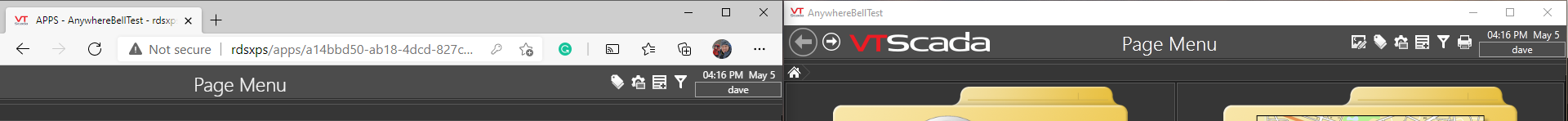

Below is an image of the result I got when testing this. You can see that the alarm icon is removed on both the server and the anywhere client. I also tested the VIC and had the same result:

@ADubberly I just tested this on my PC and I am seeing the expected result. I tested this on 12.0.33. One thing I would suggest is to try doing a refresh of the cache in the browser using Crtl+F5 in the browser while logged into the Anywhere client. Also, if you are not using the latest version of VTScada, I would suggest upgrading. Below is an image of the result I got when testing this. You can see that the alarm icon is removed on both the server and the anywhere client. I also tested the VIC and had the same result: ![6092eff5e40dd](serve/attachment&path=6092eff5e40dd)
