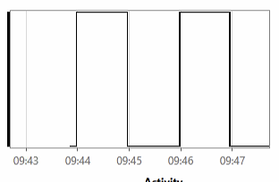

We have one digital point at index 0. It reports a change exactly on the minute change with a changing event time of 10,20,30,40 or 50 seconds earlier.(i.e. report time 10:02:00, event time 10:01:50)
Wire shark shows the event time correctly in the message. However, the Plot Data graphic and the Historic Data show it changing on the minute.60993a5c5283a
We have one digital point at index 0. It reports a change exactly on the minute change with a changing event time of 10,20,30,40 or 50 seconds earlier.(i.e. report time 10:02:00, event time 10:01:50) Wire shark shows the event time correctly in the message. However, the Plot Data graphic and the Historic Data show it changing on the minute.![60993a5c5283a](serve/attachment&path=60993a5c5283a)
Is there a time difference between the controller and the workstation? It is very easy to be 10 seconds out of sync if the controller and workstation clock are not being synchronized at least monthly.

Time is synchronized on both outstation and VTScada. I believe this may require the point to be logged in VTScada. However, it is not intuitively obvious how to do this.
Support for Outstation timestamped events is fundamental to DNP3 operation and is used by many customers, so I'm not sure what's going wrong for you.
Can you confirm that you have NOT checked the DNP3 driver config checkbox for "Timestamps are in local time"? This is a legacy option for really old devices that don't confirm to the DNP3 requirement of sending events in UTC.
If the Outstation requests time synchronisation by setting the IIN Need time flag (IIN1.4) then the DNP3 driver will send time info to the Outstation so that VTScada and the Outstation are in sync.
To see exactly what has been logged for a tag, the HDV can be switched to the "Grid" tab and the Data Mode set to "Raw Data". The timestamps shown then should line up with the timestamps shown in a Wireshark capture.
Support for Outstation timestamped events is fundamental to DNP3 operation and is used by many customers, so I'm not sure what's going wrong for you. Can you confirm that you have NOT checked the DNP3 driver config checkbox for "Timestamps are in local time"? This is a legacy option for really old devices that don't confirm to the DNP3 requirement of sending events in UTC. If the Outstation requests time synchronisation by setting the IIN Need time flag (IIN1.4) then the DNP3 driver will send time info to the Outstation so that VTScada and the Outstation are in sync. To see exactly what has been logged for a tag, the HDV can be switched to the "Grid" tab and the Data Mode set to "Raw Data". The timestamps shown then should line up with the timestamps shown in a Wireshark capture.
