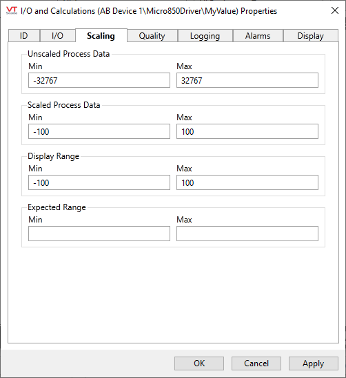

You've probably already looked at this, but you might want to check your scaling settings to ensure that you have set accommodations for the sign bit. IE: (0000 0000 0000 0000 a 16-bit integer where the MSB is the sign bit and the range is now -32767 to +32767 rather than0 to 65535)
In the case above, you'll want your unscaled value range to be -32767 to 32767 and the scaled range to be whatever should be represented by the values. See below for an example I just did for a positive and negative integer value from a Micro 850 PLC where my scaled values go from -100 to 100 (the tag output also is not an integer). Does this make sense?

You've probably already looked at this, but you might want to check your scaling settings to ensure that you have set accommodations for the sign bit. IE: (**0**000 0000 0000 0000 a 16-bit integer where the MSB is the sign bit and the range is now ````-32767 to +32767```` rather than````0 to 65535````) In the case above, you'll want your unscaled value range to be -32767 to 32767 and the scaled range to be whatever should be represented by the values. See below for an example I just did for a positive and negative integer value from a Micro 850 PLC where my scaled values go from -100 to 100 (the tag output also is not an integer). Does this make sense? ![60ba3c0869e44](serve/attachment&path=60ba3c0869e44)
Yup, tried that exact setup. Which shouldn't even be needed because we aren't reading the raw analog input value, we're already reading the scaled value in the Nx table, but either way, it didn't work. We did get it working by moving the INT to a FLT and reading that, was just curious if there was a way where we didn't have to move any negative INTs to FLTs.
