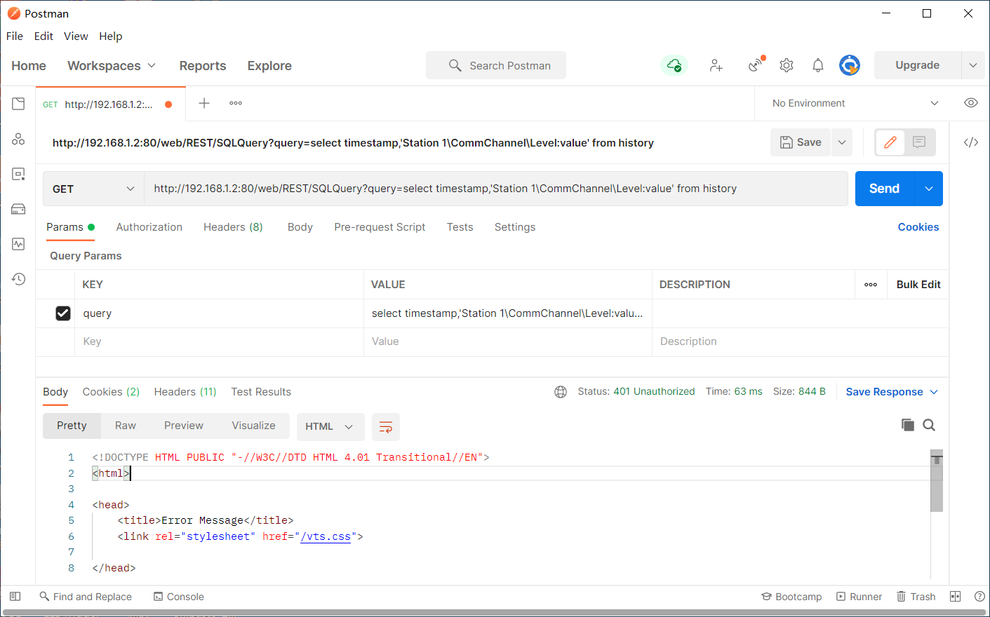

If I use postman tool that is like below picture. How should I do the Authenticate with username and password? Thanks.
60f6663249bbe
Hi, Dave, thank u. If I use postman tool that is like below picture. How should I do the Authenticate with username and password? Thanks. ![60f6663249bbe](serve/attachment&path=60f6663249bbe)
Just click into the Authorization tab and set the type to 'Basic Auth'. Then enter the username and password for a user with the 'Remote Data Access' privilege in VTScada.

@Dave - VTScada I have got the tag data by postman as your guidance. Thank U.
