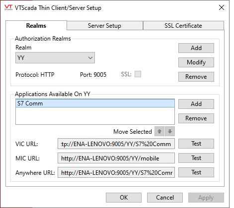

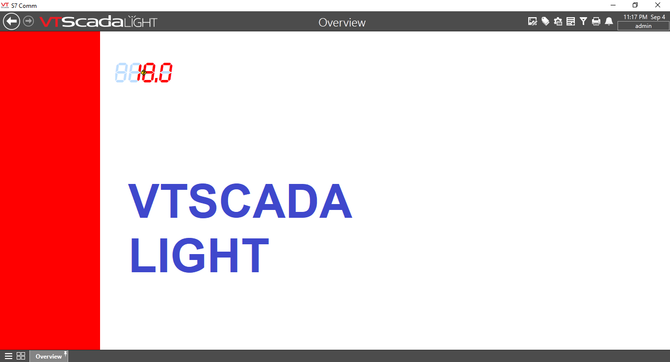

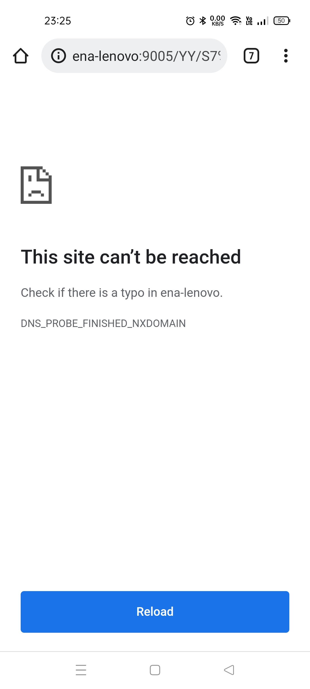

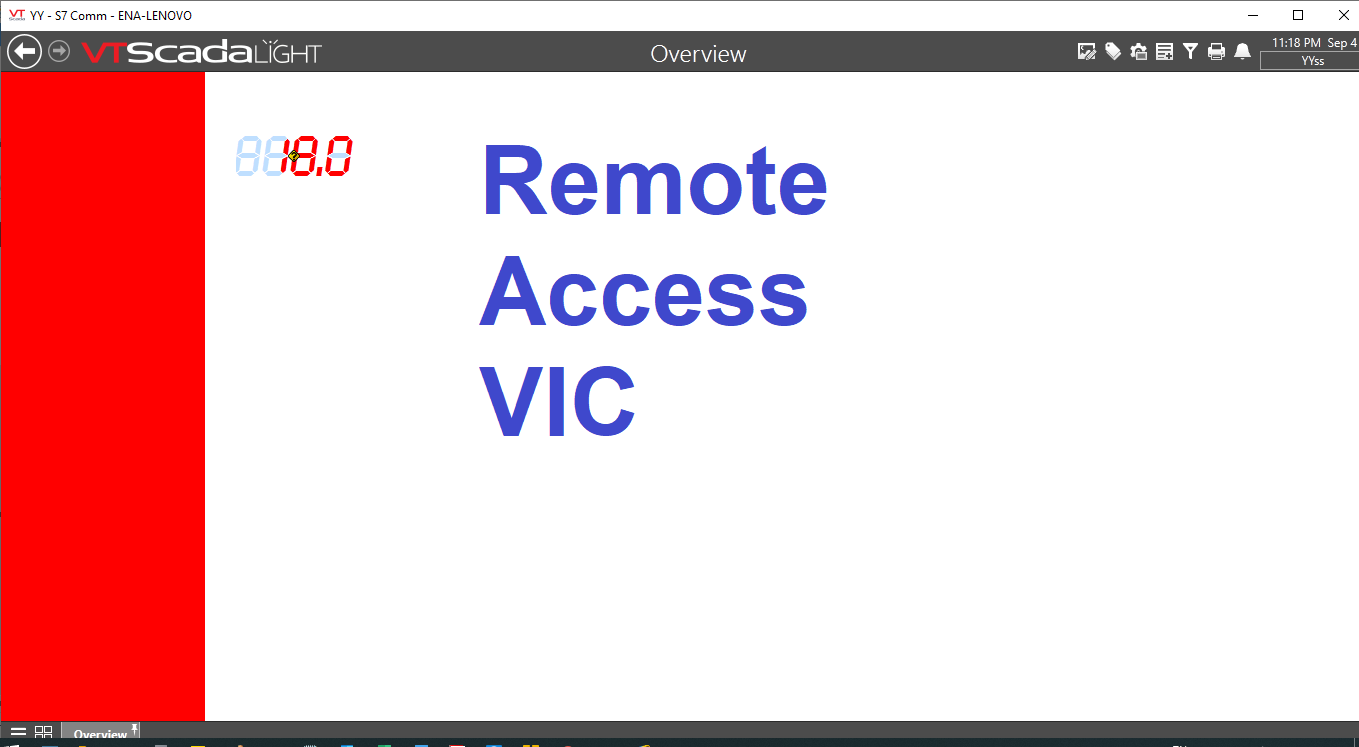

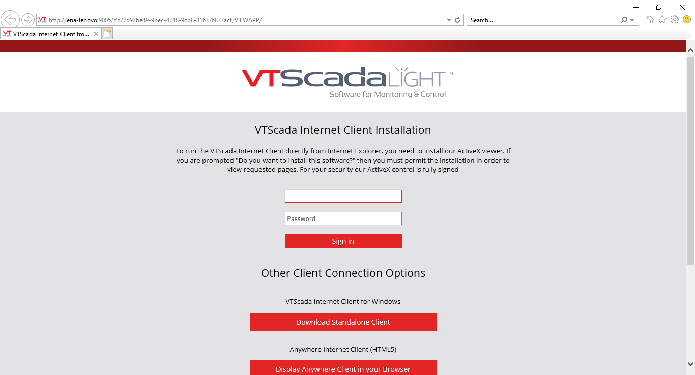

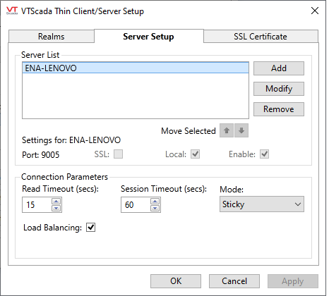

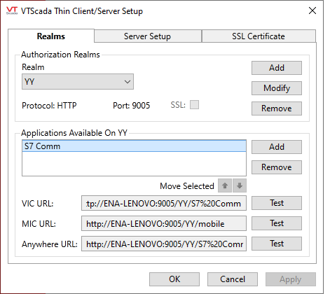

Hi,
I already setup a simple test project for thin client remote access.
I able to connect remotely using laptop via the URL given ( VIC/MIC/anywhere.
Unfortunately i not able to access remote using mobile browser.
Please advice

Hi, I already setup a simple test project for thin client remote access. I able to connect remotely using laptop via the URL given ( VIC/MIC/anywhere. Unfortunately i not able to access remote using mobile browser. Please advice ![6133905b305d7](serve/attachment&path=6133905b305d7) ![6133905b660a6](serve/attachment&path=6133905b660a6) ![6133905b6c07b](serve/attachment&path=6133905b6c07b) ![6133905ba9897](serve/attachment&path=6133905ba9897) ![6133905c12f84](serve/attachment&path=6133905c12f84) ![6133905cbcdfb](serve/attachment&path=6133905cbcdfb)
Can you download bash or similar on your phone to test the connection to your PC? I would expect this to work if both devices are on your LAN or connected inside the same VPN.
Also, ensure you are connecting to either the MIC or the Anywhere URL.
Can you download bash or similar on your phone to test the connection to your PC? I would expect this to work if both devices are on your LAN or connected inside the same VPN. Also, ensure you are connecting to either the MIC or the Anywhere URL.
